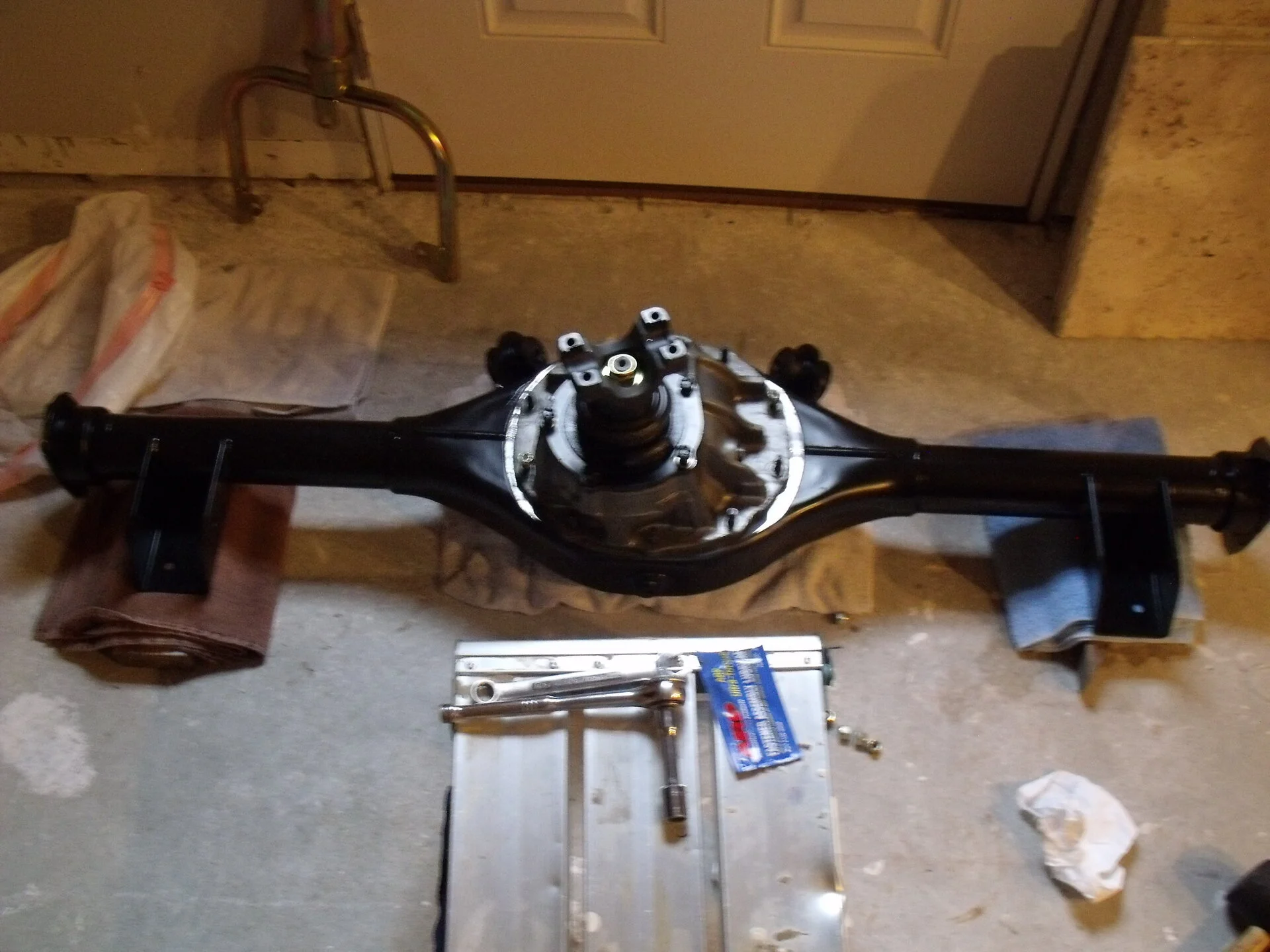

I bought SS brake lines as a replacement and replaced everything but the axle mounted lines (will do those at a later date)

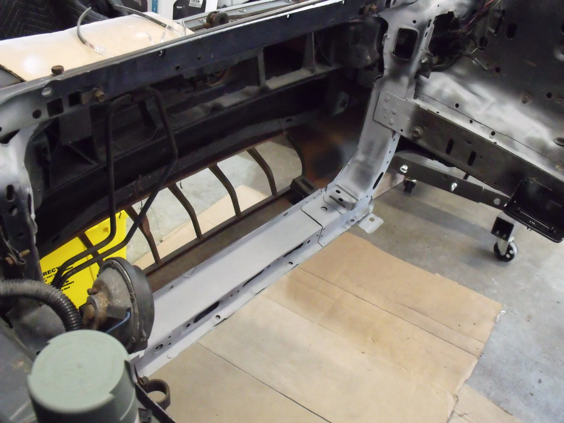

there was some slight surface rust on the Kmember, so I pulled it, wired wheeled it and etch primered the bare spots, priimered all of it, then sprayed it black... Been removing some brackets, bolts and fasteners, wire wheel them, paint them and reinstall.....
The radiator support area had some rusty spots, wired wheeled and sanded then the primer/paint ritual... Of course I am using rust oleum, which takes about a week to dry......... I SHOULD sand down the entire engine compartment and paint it, but then I would have to have some paint matched ( body color) and it would look nicer than the entire car........ Snow ball effect is correct......

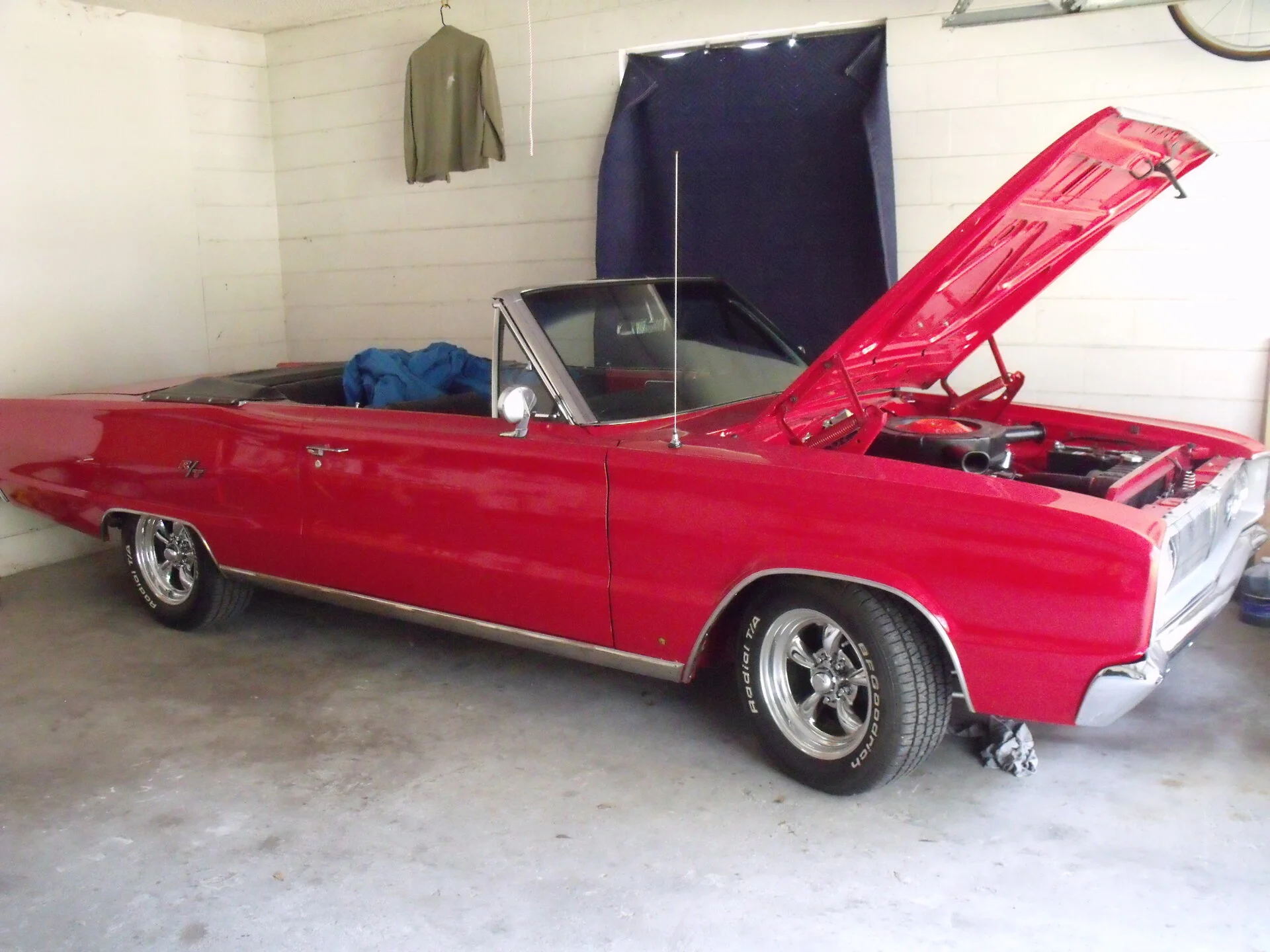

I used SS on the dodge when I did it and said I would use steel if ever again...... They say the newer SS lines are a bit "softer" ....LOL
