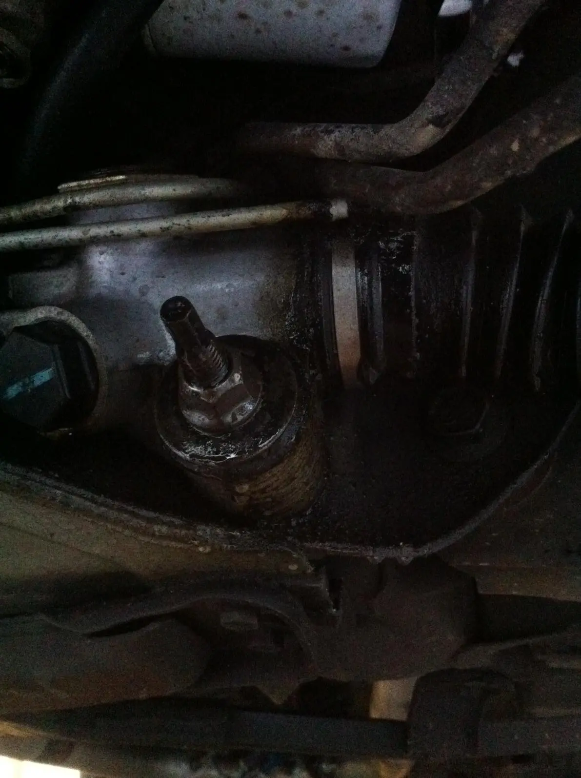

First pic showing the boot cover from the power steering, both sides are the same I highly doubt that the bend is normal. Fixable or power steering rack needs replacement?

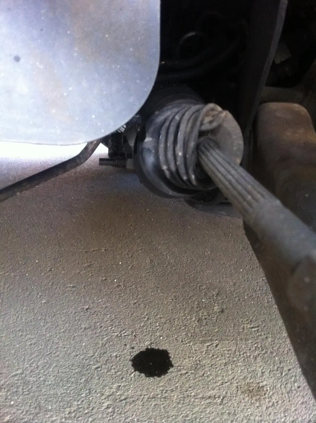

Second picture shows driver side of power steering, looks like fluid is leaking from inside the boot.

I pulled the rack out this morning. Waiting on the new on to come from a warehouse.
Rack costing me 225 plus core
Outer tie rods are 40 a pop
So about 340 after taxes here in BC.
