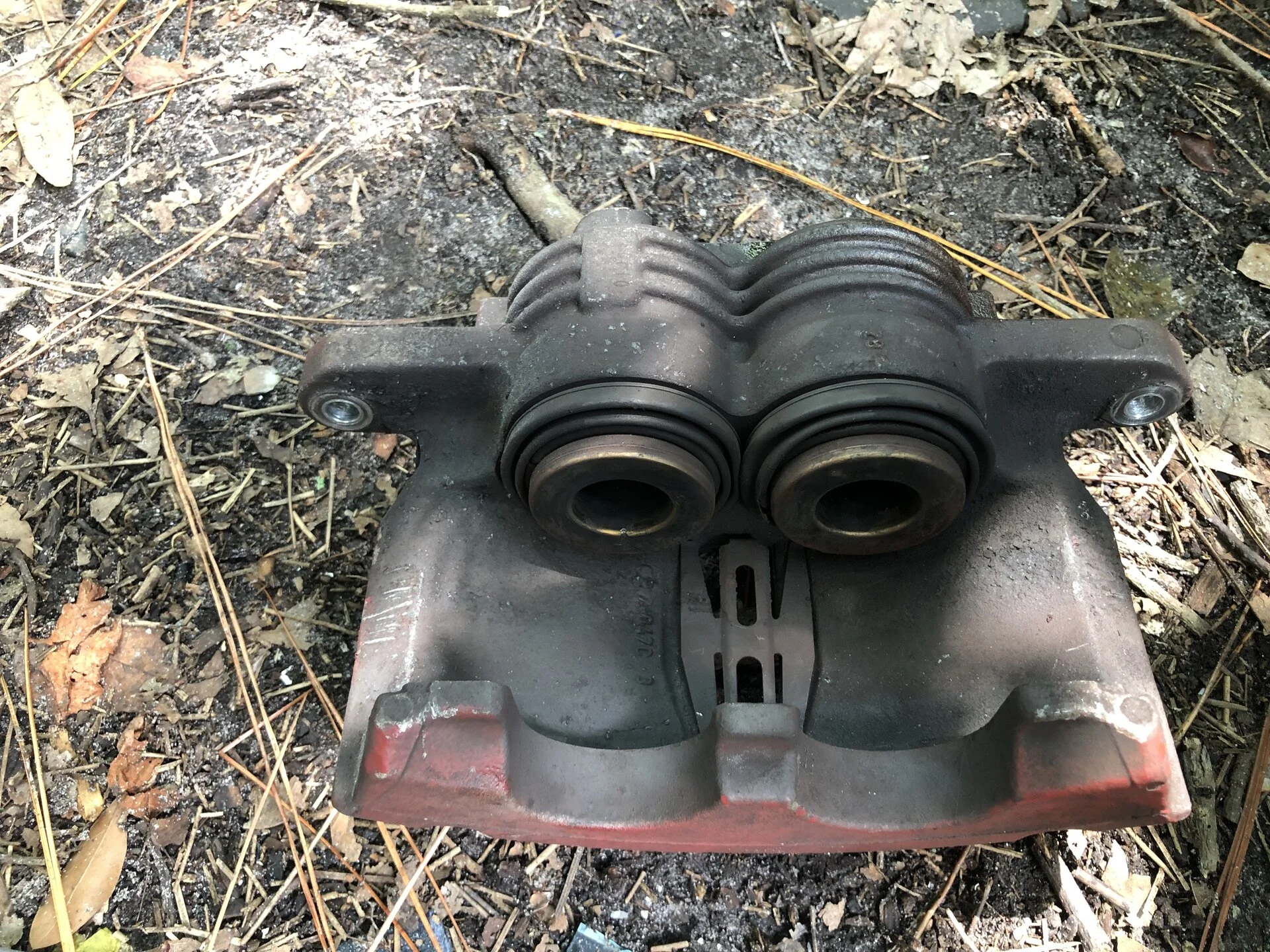

Are there different sizes brake line bolt sizes for these cars? A friend of mine had a crashed New Edge mustang that had recently had new calipers, rotors and pads. She said I could have the right front caliper as her car was totaled. The caliper looks identical to mine. Today when I went to swap them out I could not get the brake line bolt to start in the new caliper. They look the same size but it will not thread into the hole. I ended up threading it back into the old stuck caliper just to keep my brake fluid reservoir from leaking all the fluid out. It then started thunder storming so had to leave it that way until tomorrow. The caliper came off a 6 cylinder mustang and my car is a GT. Do they have different calipers?
Yes. Ford used a mix of fine thread and coarse thread calipers for the 99-04 GT/V6 PBR.
I believe it was broken down as 99-00 got one type, and 01-04 got the other. I don’t recall which was which.
just take a banjo bolt from the other car. Calipers are exactly the same otherwise
Thanks, That is my problem. Evidently 99-00 has the coarse threads and 01-04 has fine threads. I looked in the new caliper hole and looks coarse. Also I noticed when I took the caliper off the parts car the brake line bolt had a 12mm head and my car has a 15mm bolt head.
Don't worry about the hex head size of the banjo bolt. New bolts will most likely be 10mm, 11mm or 12mm. That 15mm is a big block type that was used. Once you find the correct thread pitch you can purchase new banjo bolts. fyi, my front hex takes a 10mm while the rear is a 11mm

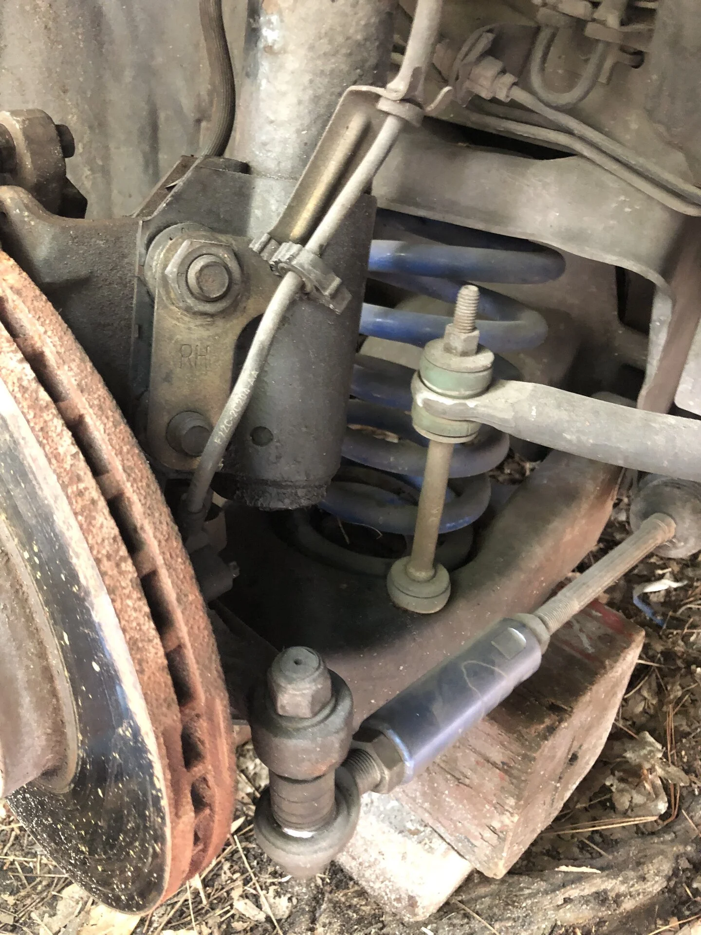

Dang, I had to pry the old caliper off. It had a grip on the rotor. The pistons are locked tight. Should the strut be at that angle where the spindle attaches? The previous owner lowered the front. I like the rake but its a rough ride.
Yes, that looks normal. Previous owner most likely just put lowering springs in to do the job. That's what sets the ride height. You can look at shocks to see what/if anything was done there. Sometimes you can combat the stiff ride with adjustable shocks to give a better rebound. If they're too stiff, it'll rattle your teeth.
If you had to pry to caliper off, I'd ditch those for rebuilt ones unless the others you have are good. I know everyone tries to save $$ but dealing with safety items is not a good way to shortcut things.
