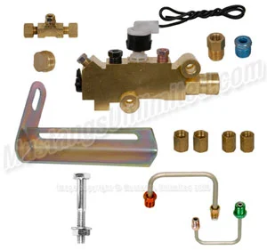

If I’m correct, can this valve be rebuilt or should a new one be purchased from a Ford dealer (since none of the part stores seem to carry it)? And Dang these things are expensive! The closest I can find online is this one from Mustangsunlimited priced at $180!!! Is there a cheaper way?
