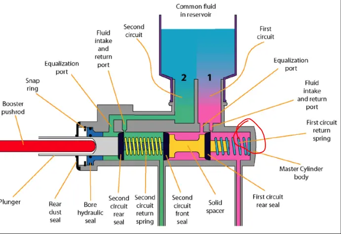

Theoretically if you introduce air into the MC, it's very difficult to get it to purge out because of the angle of the MC. It tends to trap itself at the highest point shown here in red
I think if i was doing this on my car, i'd pull the MC off and just swap the reservoir and bench bleed it. If you are going to go that far, why not just replace the MC completely? :shrug: Obviously that's your decison
