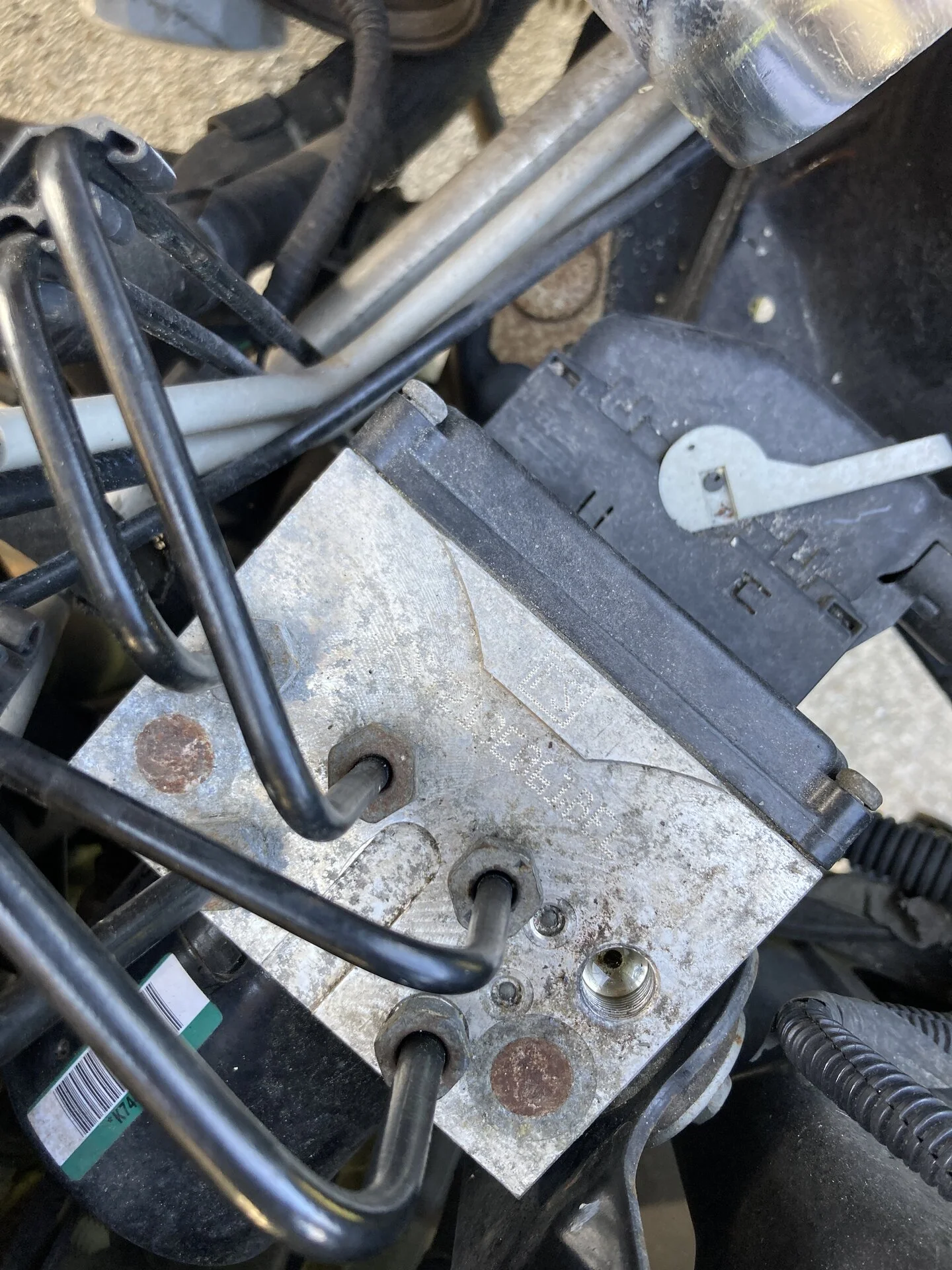

I just bought a 2008 mustang gt and a brake line busted while I was driving. I couldn’t find the exact line online and ordered the wrong part what line will I need to replace the missing one in the photo. Or if y’all can direct me to a useful website that will help too. I’m quite new to this so I need some help

I doubt you'll find the exact line (already bent) anywhere. Take the remains of the existing line...measure it carefully end to end...then take the measurement and the nuts/flared ends to an auto parts store. Buy a line 3-4 inches longer than your measurement (to allow for bends, etc...it will likely not run the same path as the old), with the correct nuts/flares on the ends. Good luck!
