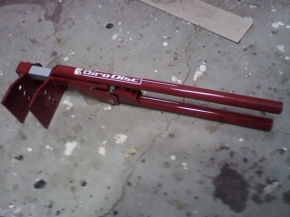

I'm changing the rear pads on my Cobra, and I can't get the pistons on either caliper to retract. I've tried using two different break pad spreaders, but the piston's just aren't moving at all. Any solutions to this problem? I've never had this issue before when I've changed break pads on other cars.

This is a good point, I was under the impression you had already tried using the autozone tool. The rear caliper pistons have to be turned in order to be compressed, the autozone adapter hooks up to a ratchet so you can rotate the piston. I tried using the tool with no luck and thats why I bought the new caliper.

Yes. You do need the tool on the rear. A little bit of grease will not hurt anything. Just be sure non of it gets onto the pads.
Keep working it with that tool and see if they loosen up. If not, you may need a new one. They do get rusty and bad after some time.
There should be a tool that bolts up and turns the pistons w/socket and ratchet.
There is and its magic. I have the one from MATCO, SnapOn and MAC have versions as well. I have seen one from Harbor Freight also thats pretty much the same thing.
I needed this bad boy for the fronts on my mustang (2000 R front) and I use it for my Volvo (factory 330mm rotors with 4 piston Brembo calipers all around).

Sweet! :nice: How's that work? Have any pictures of it in action? And what do they run? I have a Harbor Freight near me.

That particular tool was in teh $150 range IIRC.
The one for the rear calipers from Harbor Freight was really cheap last time i checked. Its perfect for the DIYer because you will only use it a couple times.
