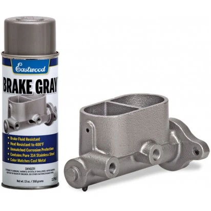

Automotive brake fluid has a solvent effect on most paints and softens them so that they blister and peel off.
Eastwood has a paint that they claim is brake fluid resistant, however it seems that It only comes in one color - gray...
http://www.eastwood.com/eastwood-brake-gray-brake-fluid-resistant-paint.html
