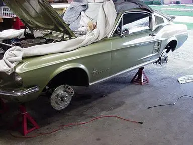

It really depends on what you want for the car. You have to specify how the car is to be driven and what kind of budget you're looking at. Here's the brake conversion I'm just finishing up...
