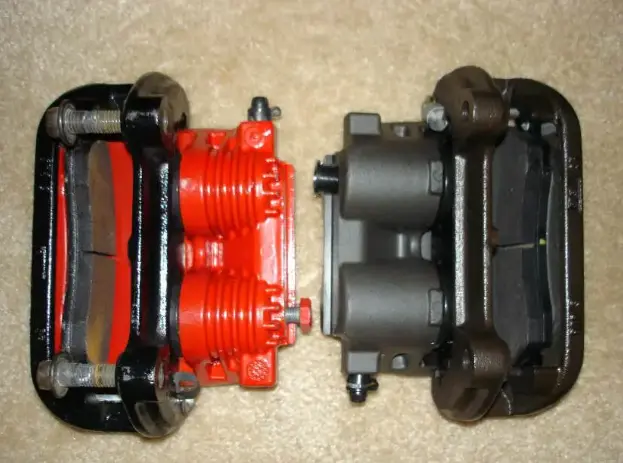

You should identify which Cobra brakes you have up front.
Look under the pistons at the rear. Ribbed bores (left) are 94-98 38 calipers, smooth bores (right) are 99-04 40mm calipers.
If you have the 94-98 Cobra calipers, i would get a 94-95 cobra MC
If oyu have the 99-04 Cobra calipers, i would get the 1993 Cobra MC
