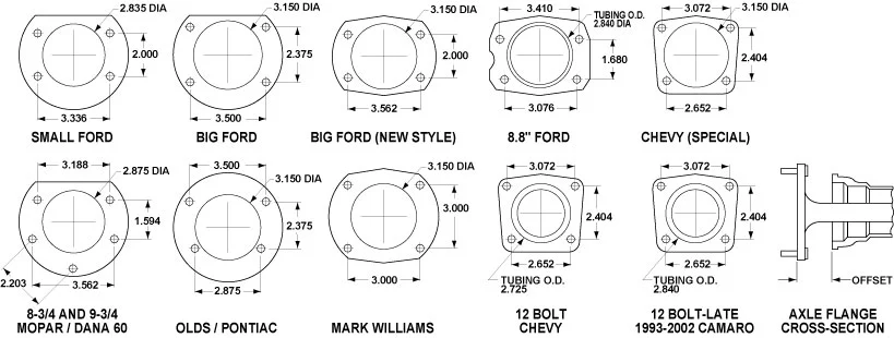

Here's a diagram of different axle housings.

Thanks again everyone! Thanks for the attachment Grabber, it will be usefull this weekend (Guess what I'll be doing) and for future ref. One more question, what would be the best way to remove the old drums? Drop the rear and then take them apart or leave the rear in place remove the drums and then drop the rear. The rear end is coming out so I can clean and paint it, I will also be replacing the shackels, bushings ect. at the same time. Thanks!
