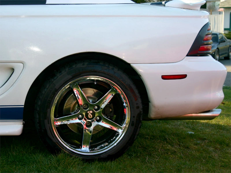

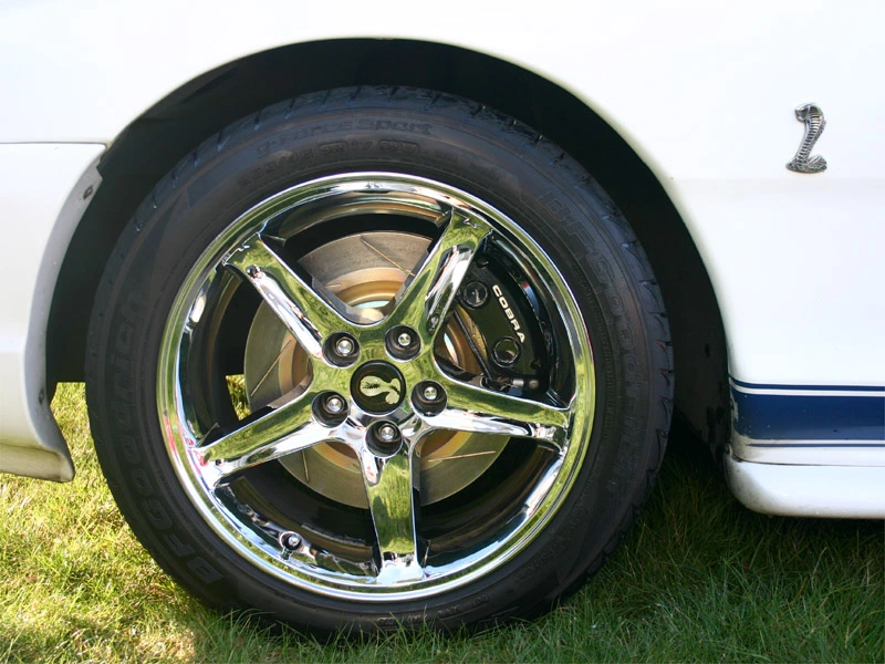

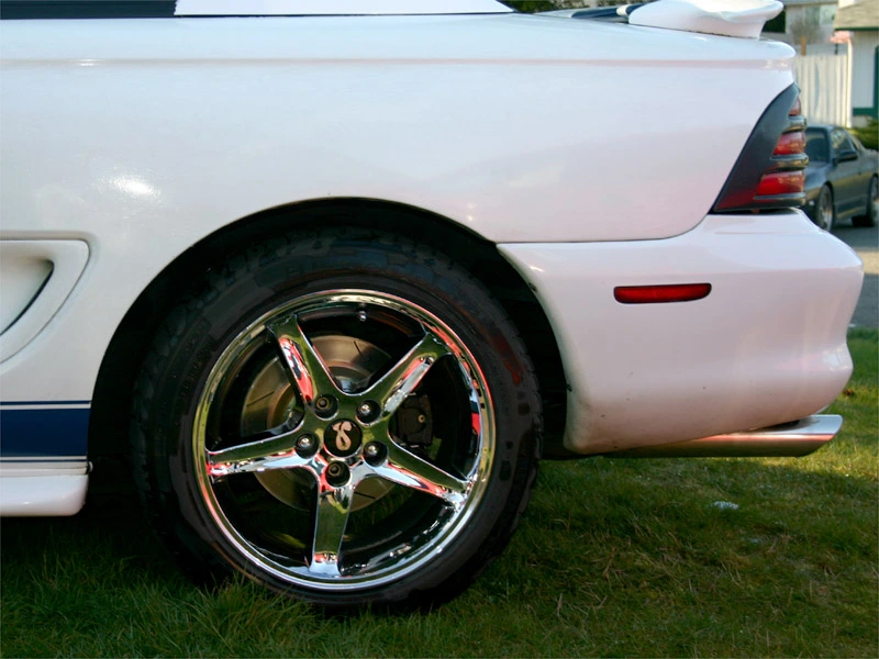

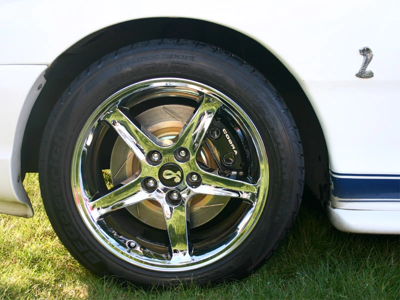

Well after much intrepidation and going back & forth between having someone else do it and doing it myself, I finally just manned up and did it in my garage!! New brembo Slotted rotors front/rear & new FMS calipers at all four corners. I also got a 5 hose stainless braided kit as well. I didn't even break anything during the job :nice:

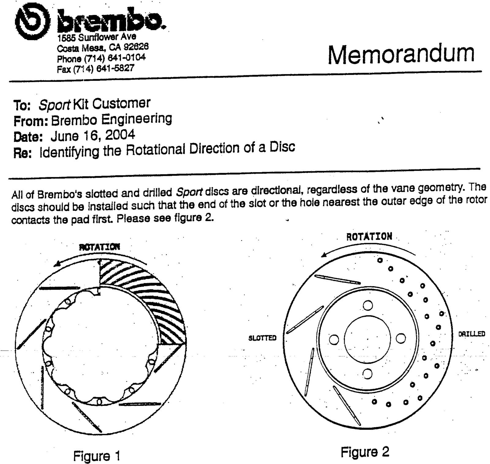

As a side note, I have attached the Brembo memo on the slot orientation of their rotors. This was included with the rotors. There was a debate on here regarding this. This should clear things up.

I just noticed that cobra badge on your car? Is it not a cobra or did u just replace the calipers on it?
Yeah it's a 1994 Cobra, #4429 built 7/23/94. I replaced the 12 yr old Cobra calipers with new Cobra calipers. I needed to replace the rears and just went and got new fronts as well since I was doing everything else. :D
