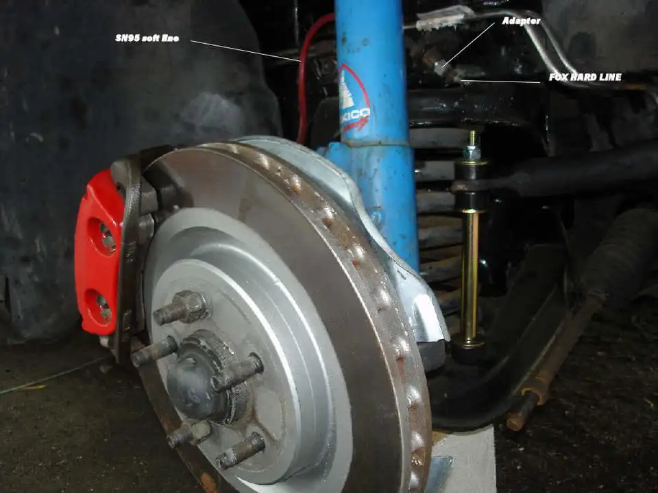

Lets try this
See what i'm getting at? If you buy 5.0 lines, you will do the same thing...this is a pic off my 5.0
^ this guy thank u .. this is wat i needed.. so here is another question.. for the e brake.. do i just order e brake cables for a sn95 and replace the ones on the fox?
