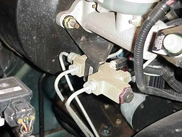

Down to business. My '67 Coupe has factory disc brakes. And the master cylinder was replaced a few years ago with a Bendix unit. The system is fully stock. I had to remove the master cylinder to detail the engine bay and ease the installation of the new motor. The problem is with the rear brakes. I am not getting any fluid to them. They are not working at all. I have bled them several times and still nothing. I adjusted the star wheel and am not getting anything. I cleared the line of all fluid from the the master cylinder to the junction at the rear. For some reason I can't get fluid through to the drums.
What can I do?
If you have a combination valve, it's possible the piston inside shifted and is blocking the rear output. It can be reset by pushing the pin back in so it's at the neutral position.

Tim, yes 67s have them and good call.
This is most likely the problem. These things are nothing but trouble and I'm surprized anyone besides me mentioned it. Take that POS out of there and replace it with a brass T block for the front and a straight through coupler for the rear. The only thing you loose when you do this is the brake warning light. If you can't feel the problem in the pedal that the brake warning light would indicate you shouldn't be driving a car.

Look for a pin about 1/8" in diameter sticking out the end of the combination valve. Look on both ends. It may have a rubber cap over it. Push it back in.
The purpose of it is in case a leak developes in the rear, the pintle moves inside blocking the fluid to the rear, thus still having front brake operation. If the leak is in the front, visa versa (hold on, 'cause the back brakes only will give you a ride.) :eek:

Here is a picture of a combination valve.
oh, Tim not all combo valves have the pintle accessible like that. for instance the pintle on my 69 isn't accessible like that. there is a procedure in the 69 shop manual explaining how to re-center the pintle should this happen and it's kind of a pain to do, requiring a helper to do so.
I realize that, but I was just trying to help the guy out and cover another possibility. Maybe you could mention a couple of the steps to re-center a non-accessable pintle type combo valve. :)
Just read this in a 64 Galaxie shop manual. THis car had this problem. The "proceedure" by the book to reset the pin after it has shifted. Fix the leak that caused the loss of pressure in the brake circuit. Then, open the line that was ok. Press the pedal to pressurize the failed circuit, the good circuit will now have no opposition so the pin will slide back to center. You use the brake light to know when the pin shifts enough. Meaning the light will go out. If it goes out and comes back on, the pin shifted to the other side and you will have to reverse the process. Make sense? Barely.
Alternativly, you can contort yourself sideways and upside down in the engne compartment and take the little plug off the back of the combo valve, dropping your 3/8 wrench on the floor 52 times...saying "darn it, I dropped my wrench again!, and pushing the pin manually back into the centered position.
Or, just take it apart, take the combo valve out of he car, reset the pin, put it back in.
As long as the presssure is equal front and back, the pin stays centered and the light off.

you can also crack all the lines on the valve one at a time and have the helper stomp the pedal to help re-center the pintle and do it to each line one at a time until the light goes out. if that doesn't work repeat the procedure but lightly tap the valve with a hammer while the helper stomps the pedal, been there done that, one of my old bosses taught me this trick on an old LTD we worked on.
