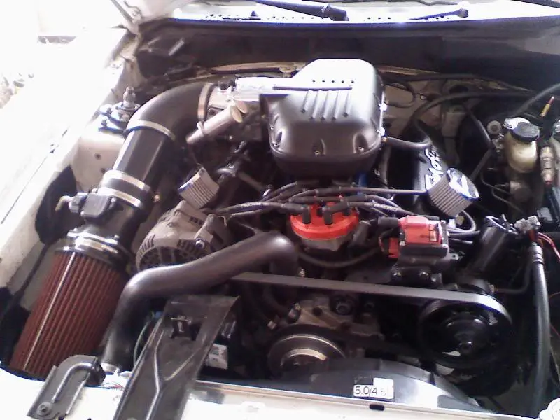

I love my bread box!
I've shortened the runners 1/2" and I still make over 300rwtq before 3,000rpms in my little 331cid
