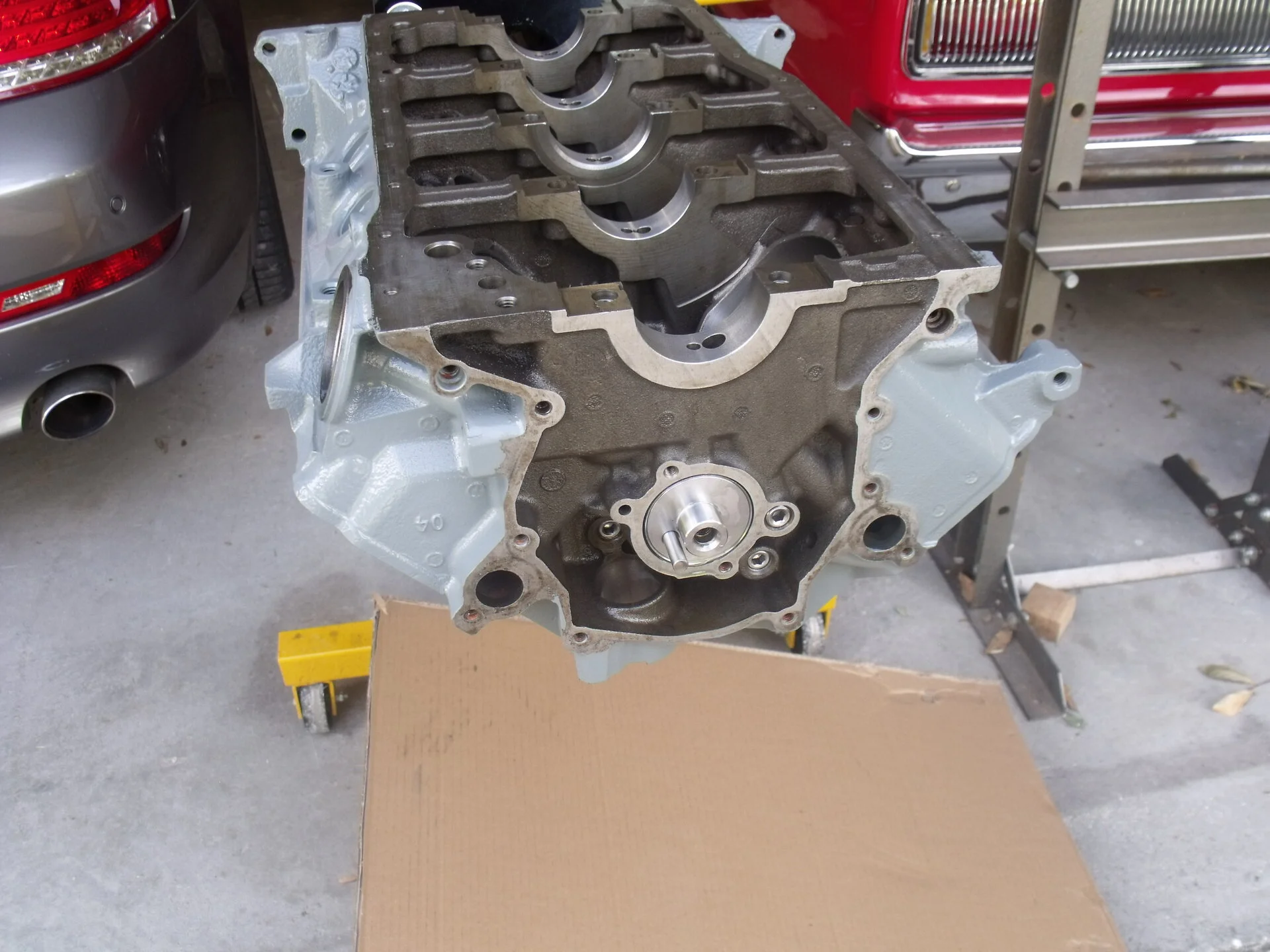

Is this a fresh build?
Yes 030 over with new pistons, bearings, cam and pretty much everything......

Ohhh you threaded the front galleys! Nice!
