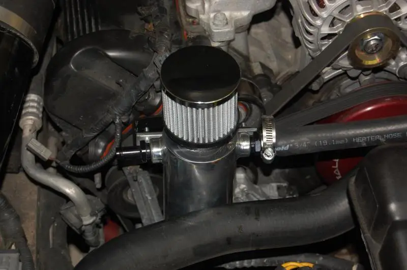

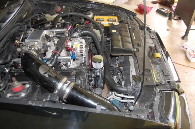

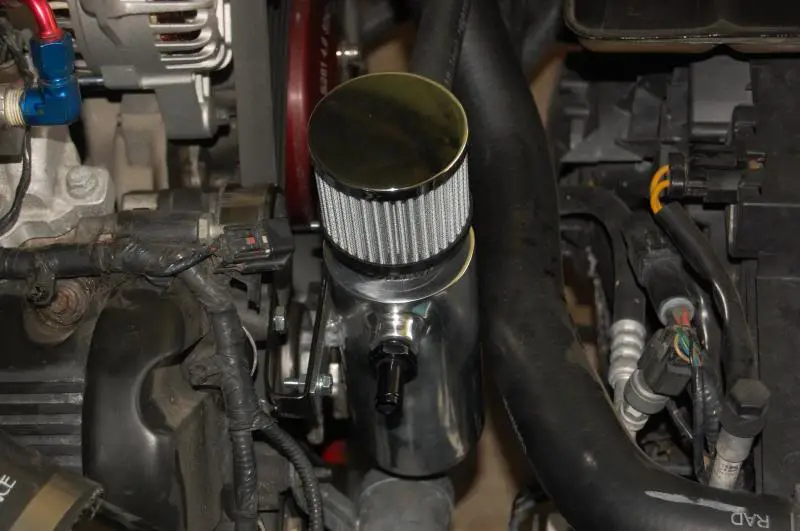

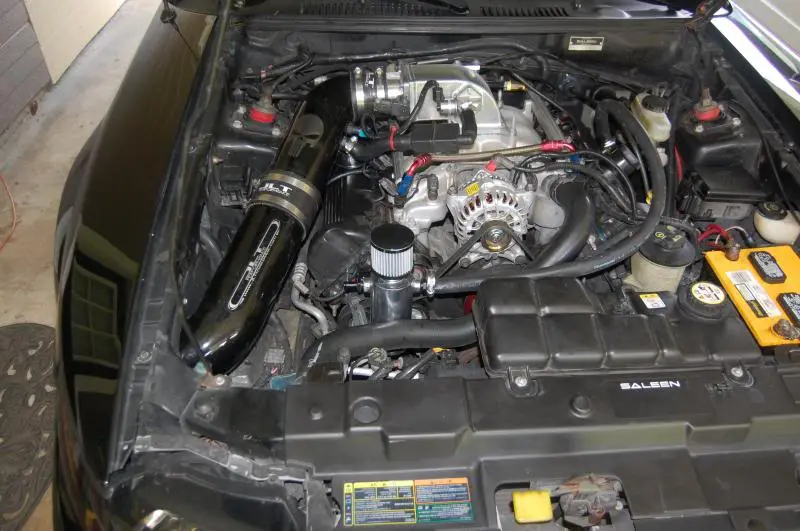

Mounted a catch can on the car today. I had to fashion a bracket from an "L" shaped shelf bracket I picked up from a hardware store. Funny thing is the two holes on the bracket matched the catch can mounting hole perfectly. I removed the support piece and bent it to form a U. I then cut the excess and drilled holes to mount to an unused bolt hole on the head.
