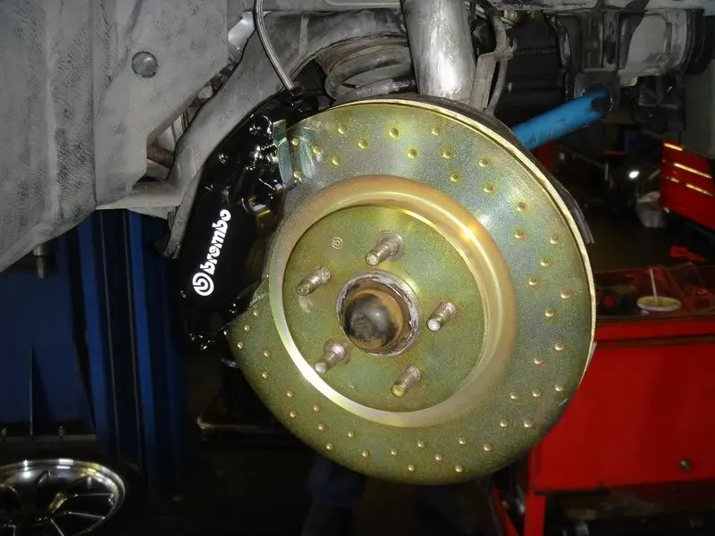

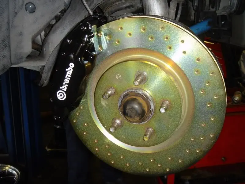

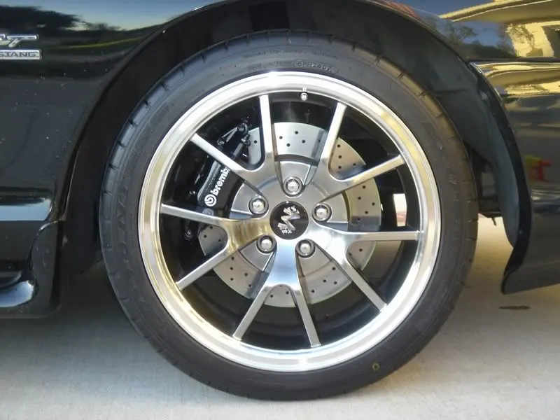

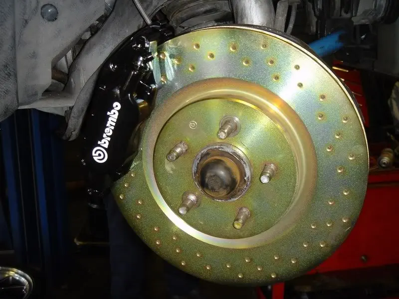

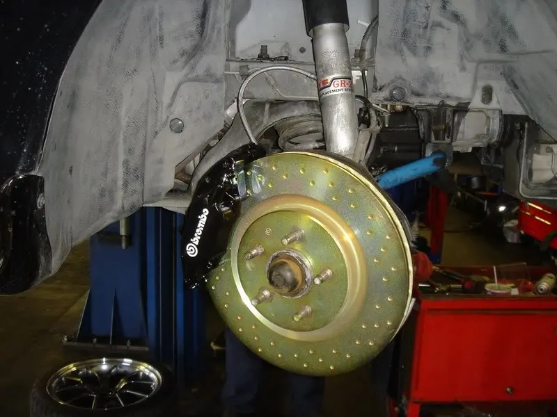

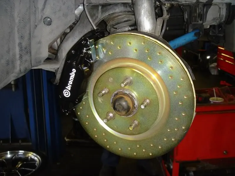

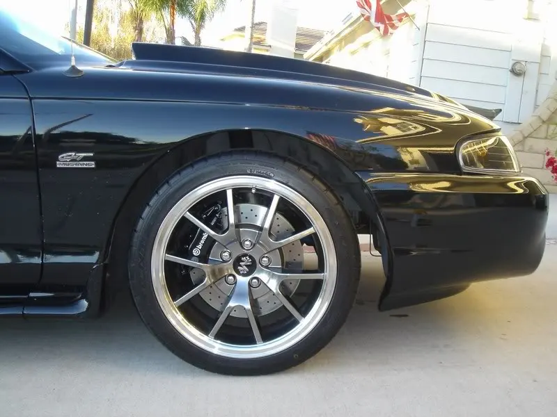

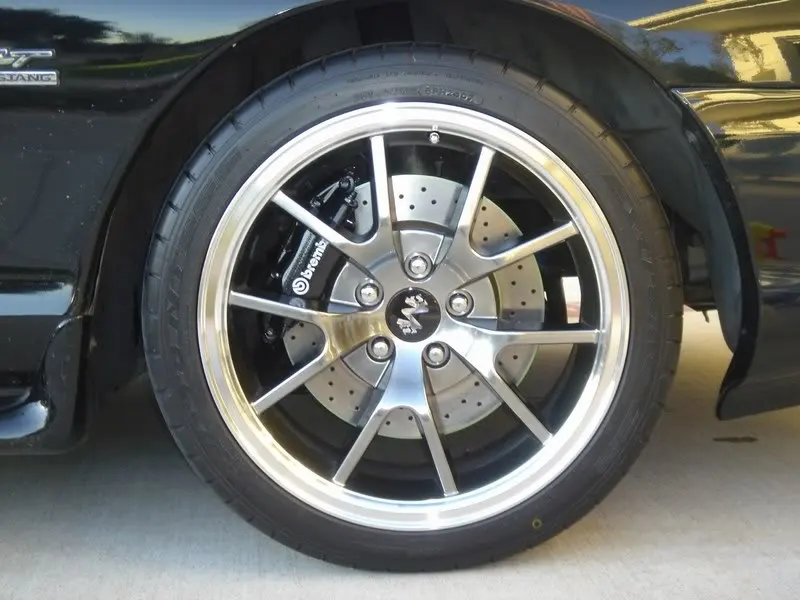

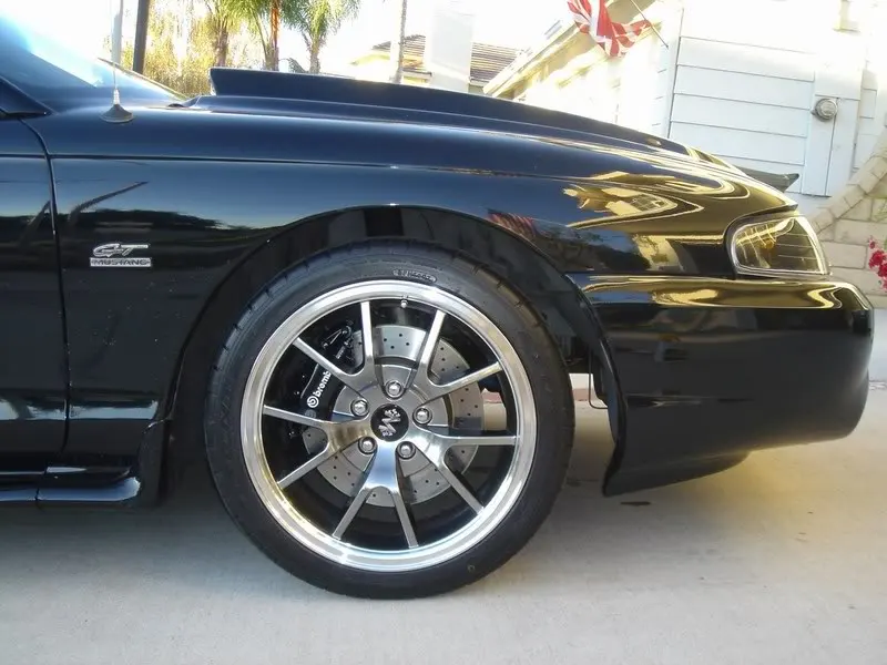

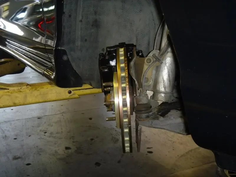

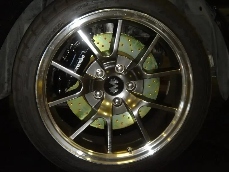

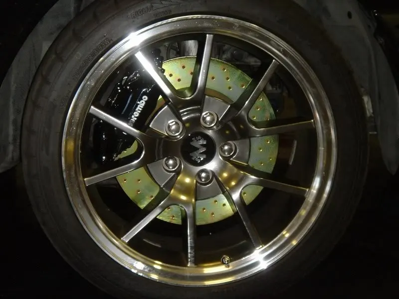

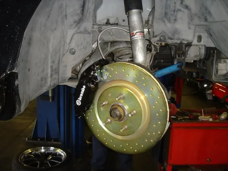

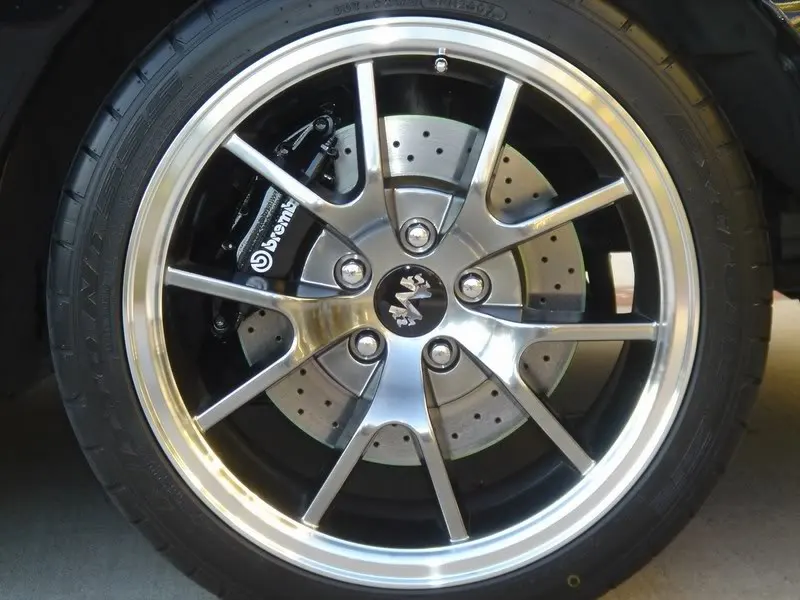

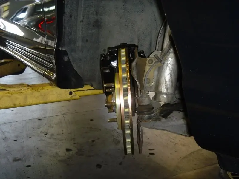

Brembo Kit Installed!!!
I had the day off and some extra time, so I cruised down to work (I work at a Chevy Dealer) to throw the Brembo kit on the Stang. I have to say that the installation of the Brembo kit was the most seamless process of any aftermarket part I have ever installed. This kit fit like a glove. I could not believe how easy it was and how perfect it fit. Here are some pics:
I'm still waiting for my rear kit. I will keep this updated as I make more progress on this install. Thanks for looking.
- Justin
