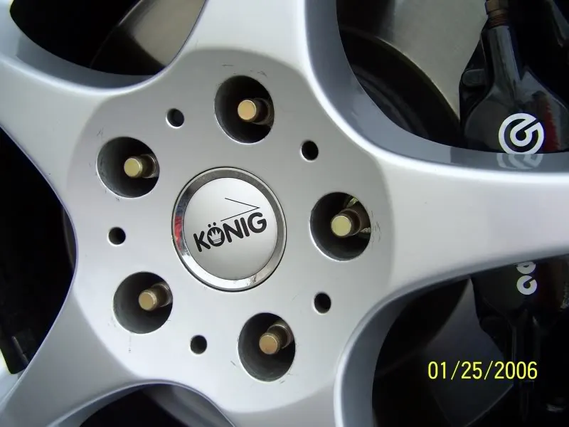

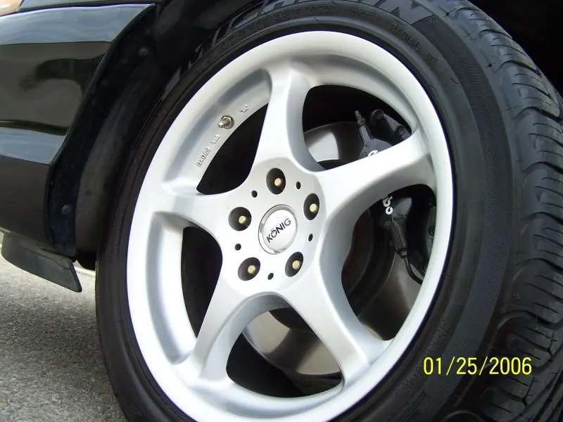

not true 17s with no spacers. 98 Cobra wheels will also clear as Ford used them as a spare tyre on the 2000 Cobra R's.
