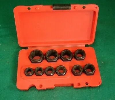

I have a set of these Craftsman extractors. They have saved me multiple times. Either a rounded bolt head or a snapped bolt. As long as there is enough sticking out to grab on to, they work better than I thought they would. I tap them on with a hammer to get a starting bite. Then as you crank on them they bite in harder.
If you have or can get your hands on a set like Dirks showed, that would be a good place to start. Otherwise, slot it, heat the crap out of it, and back it out.
