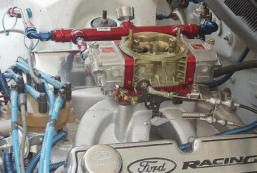

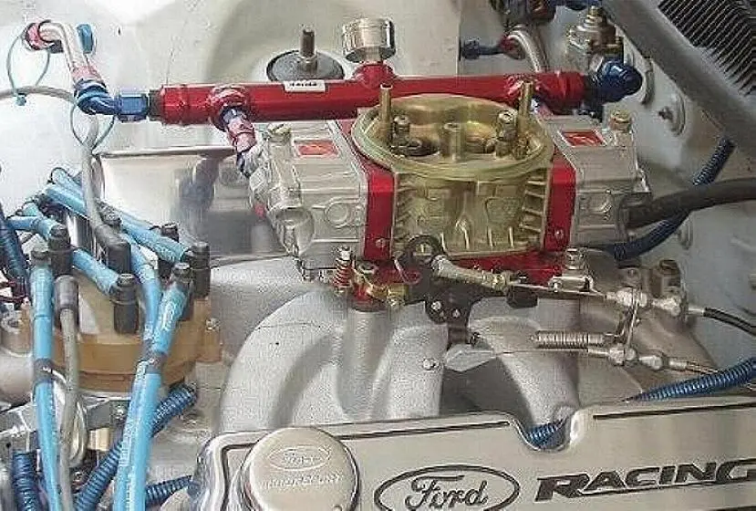

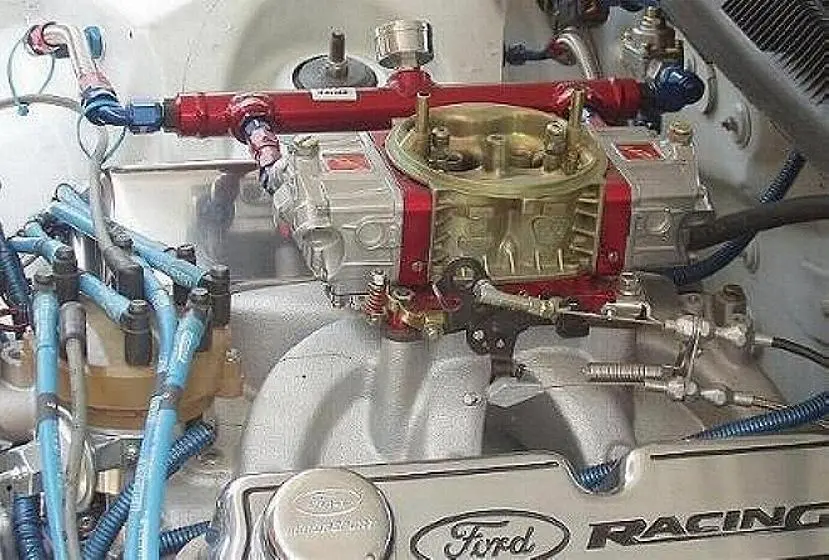

I am using the Lokar cables and bracket on mine, and it works great.
where did u get that fuel tube with the guage on it that runs the lines to your carb?
