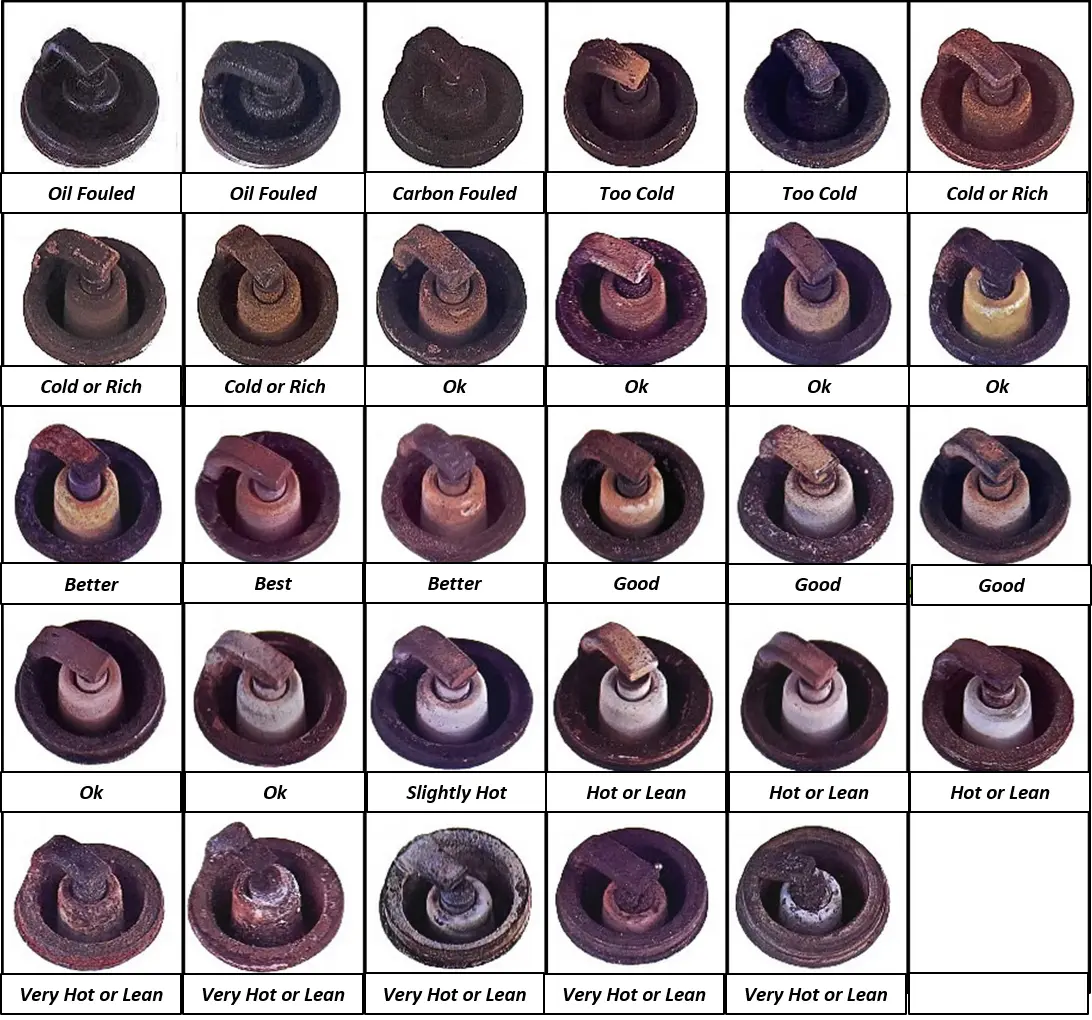

Replace all the ignition coils. They can misfire and not throw codes. You will notice a big difference when you replace them all at the same time. The car will run like new with new coils, plugs and injectors. Timing can definitely be an issue but rare in most circumstances. Did you use a spark plug chart to see if the ones you had were good? I've attached one below for reference. Hopefully you did this. If you plan on taking the plugs out again take a picture of each one and label which cylinder it came out of. A lot of times you can diagnose whats going on by looking at a spark plug.

Yea I pay close attention to the things I touch because I’ve had the car about 7 months now and even though it’s low on miles maintenance was definitely neglected on it so I’m just working my way through systems but it’s like Pandora’s box. Fix one thing for preventative maintenance and it takes out a related system that was just barely hanging on..... I just have to remind myself that I love this car lol
But the plugs were definitely about 20% overdue based on run time. With cylinder 3 being the worst culprit. So I’ll have to keep an eye on things moving forward
