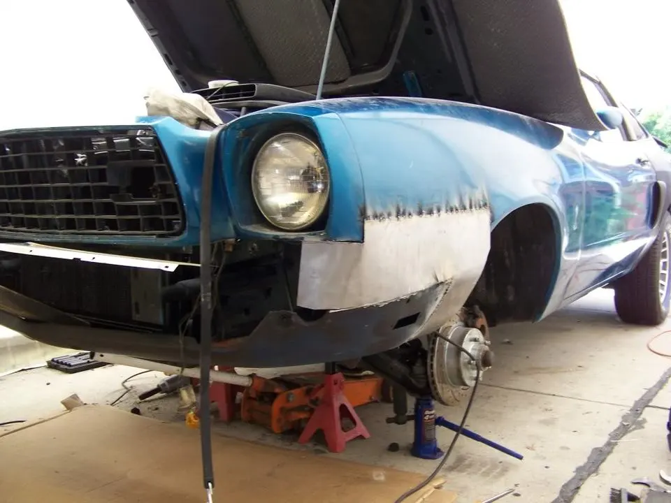

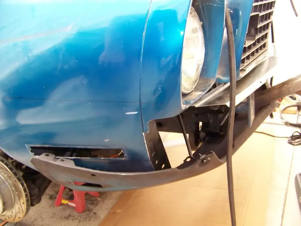

69 valence:

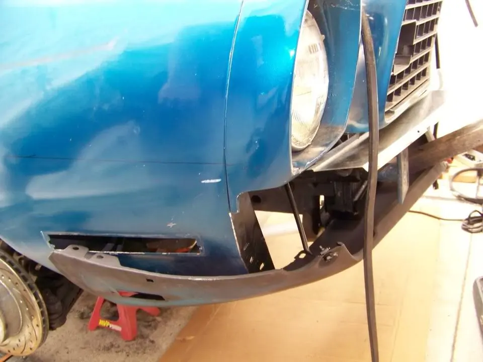

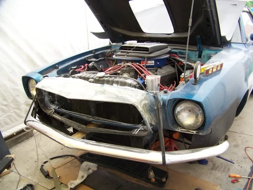

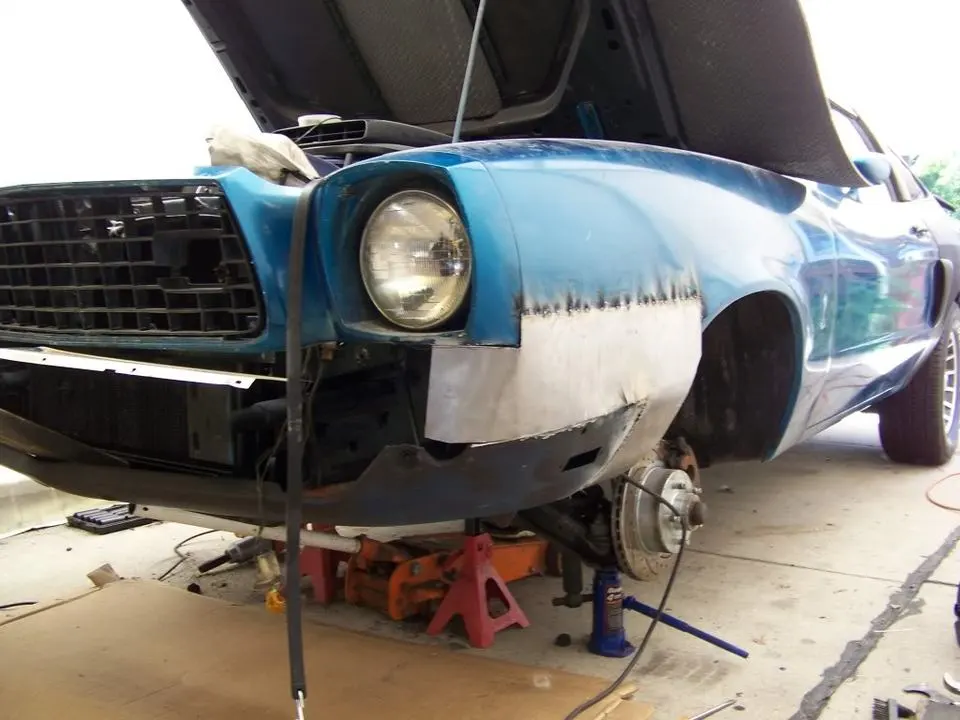

Extended and pointy header panel:

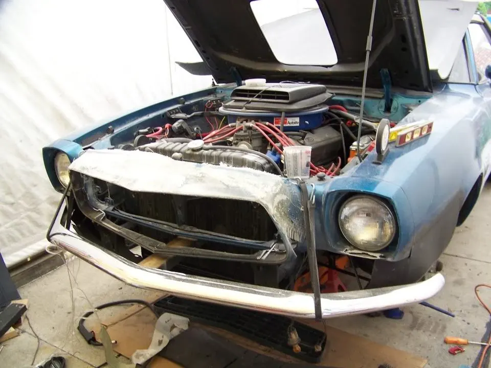

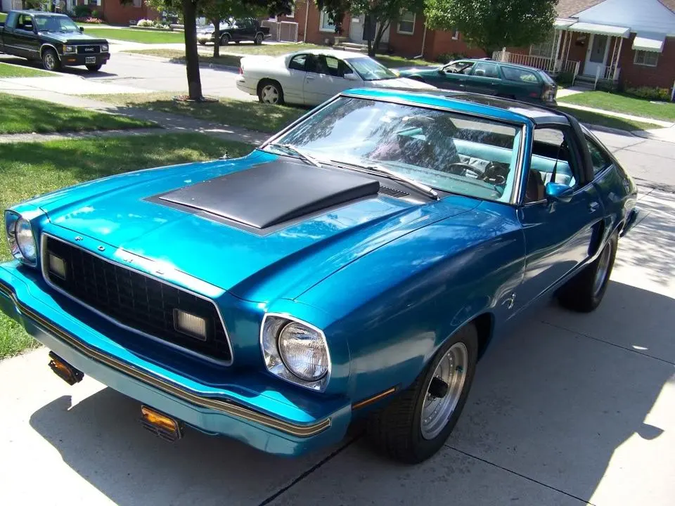

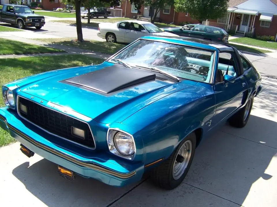

Current near- finished header with shaker hood:

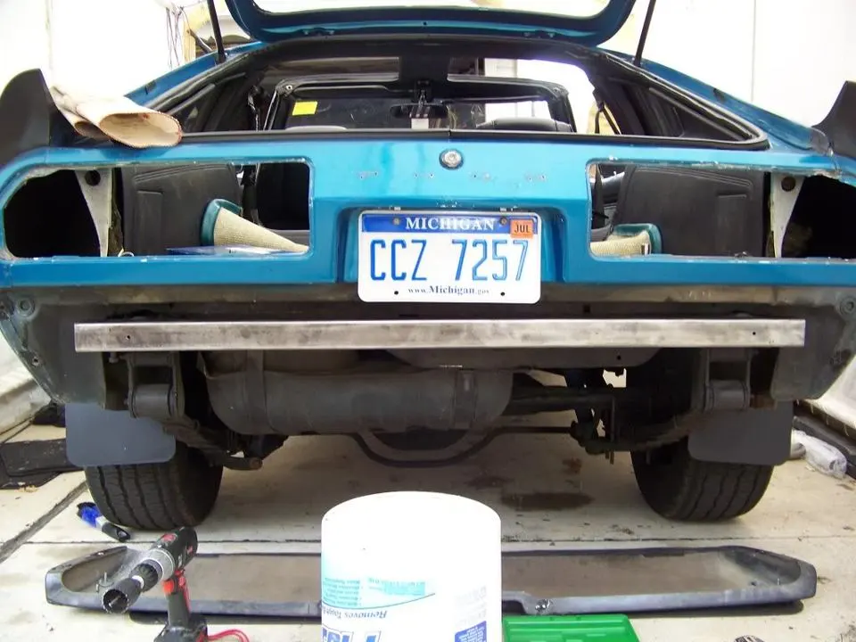

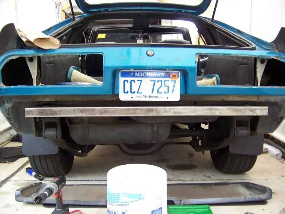

Rear bumper removal and small steel replacement:

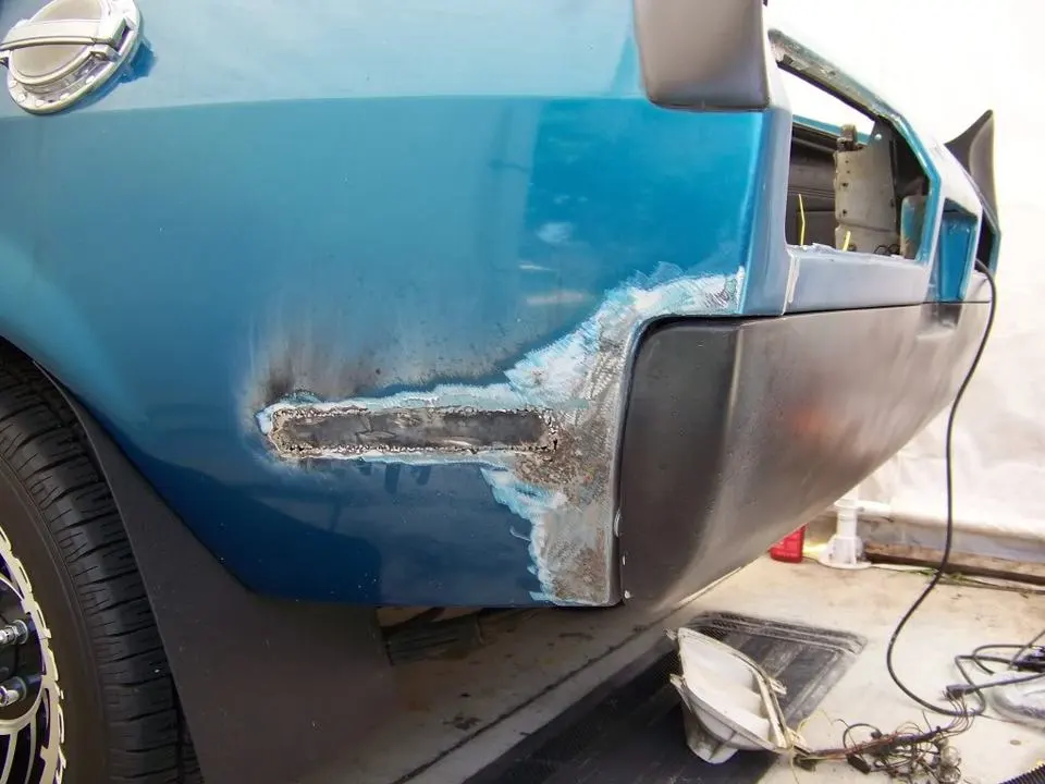

Marker lights filled (they leaked):

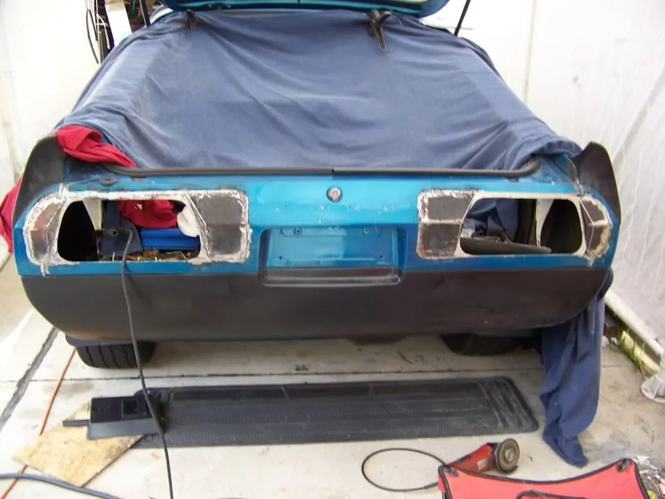

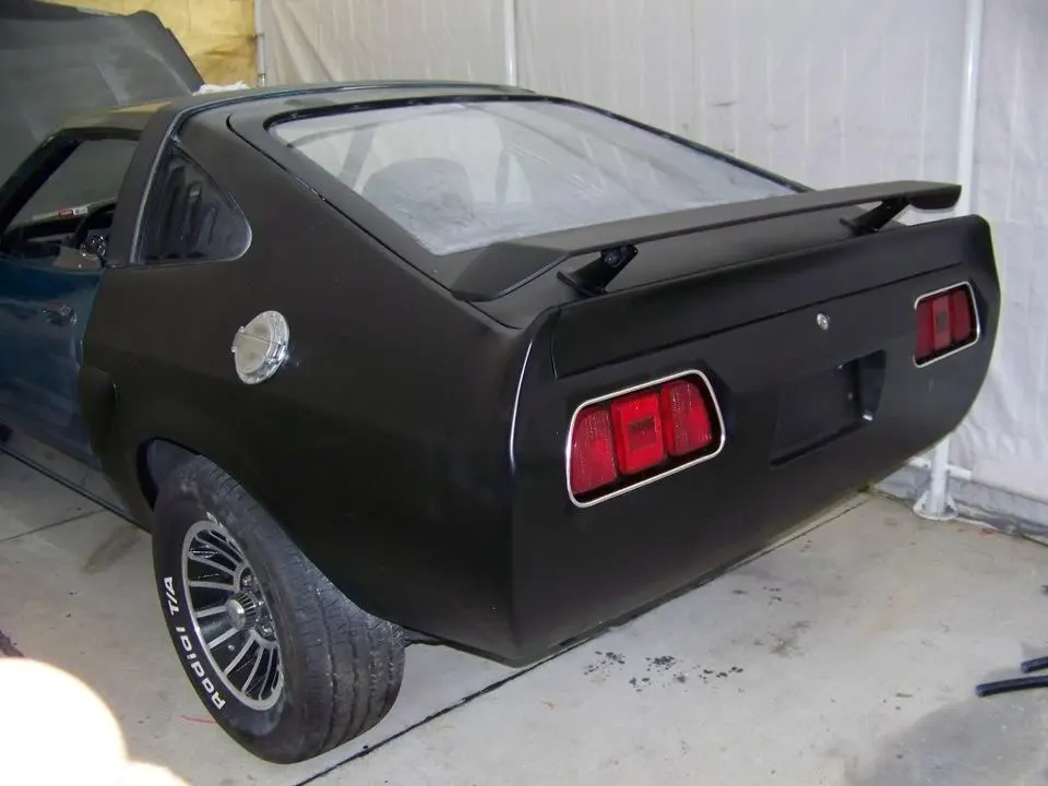

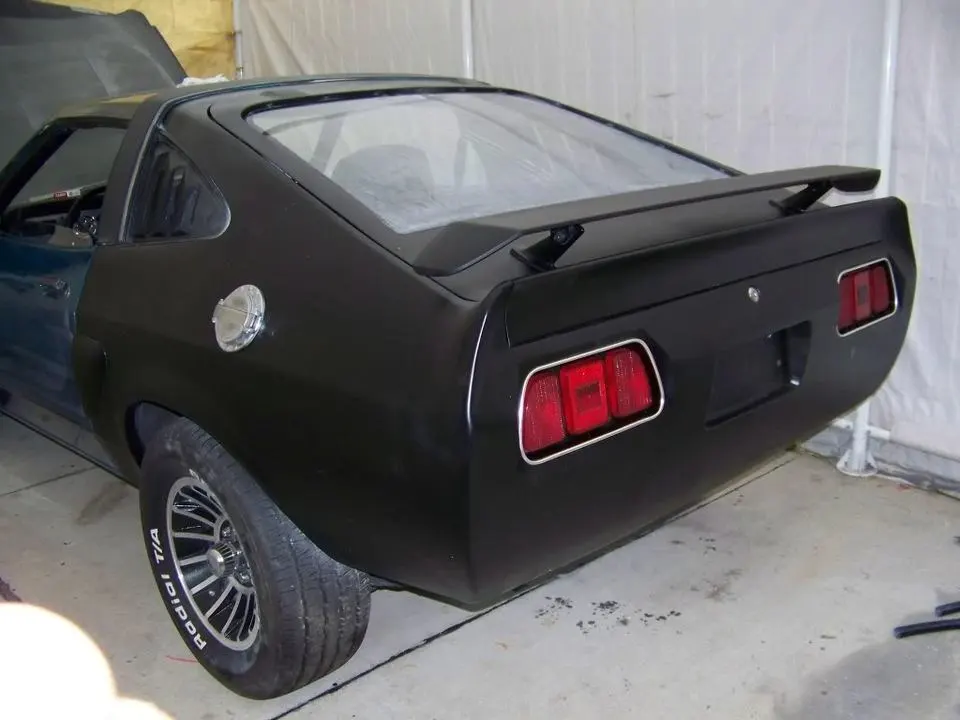

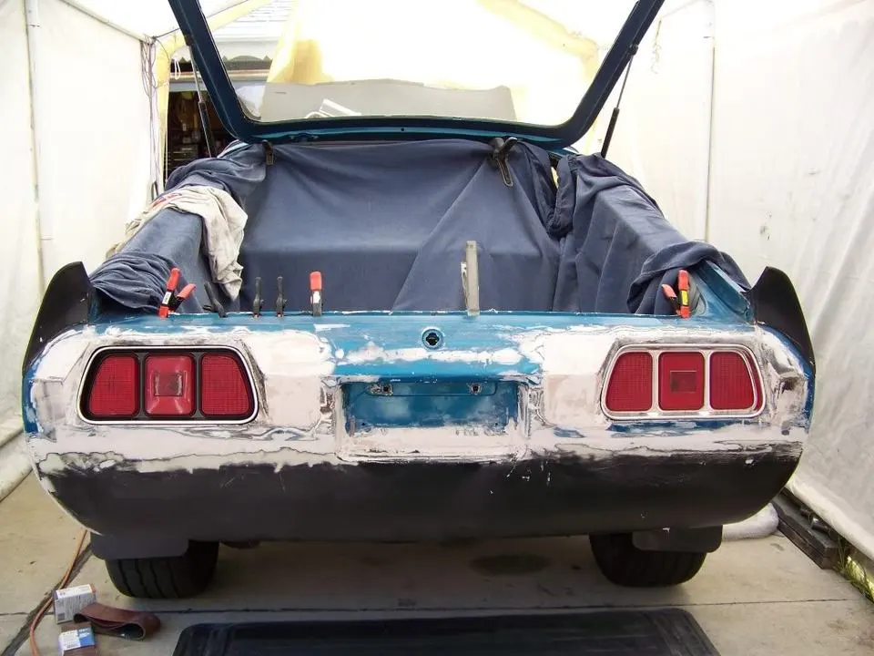

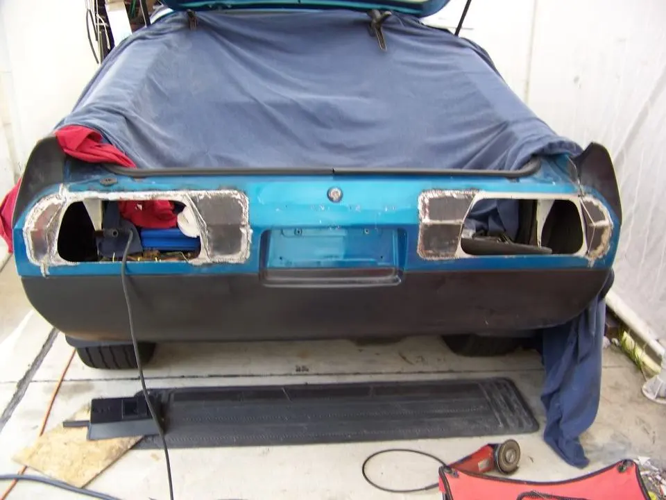

Roll pan added and tail light openings modified to accommodate 71 tail lights:

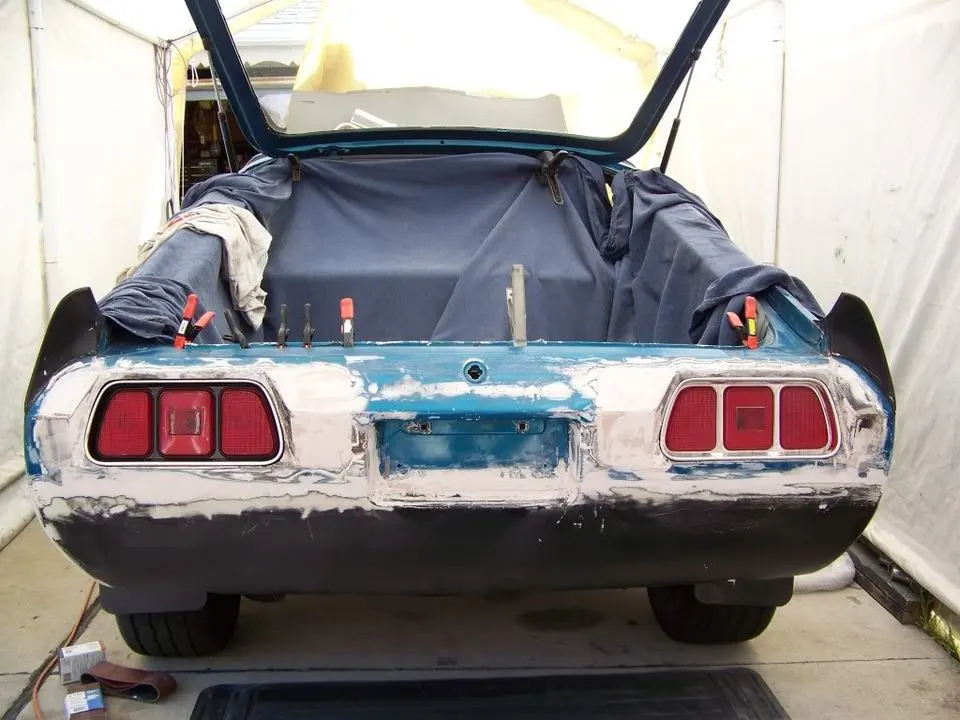

Filled:

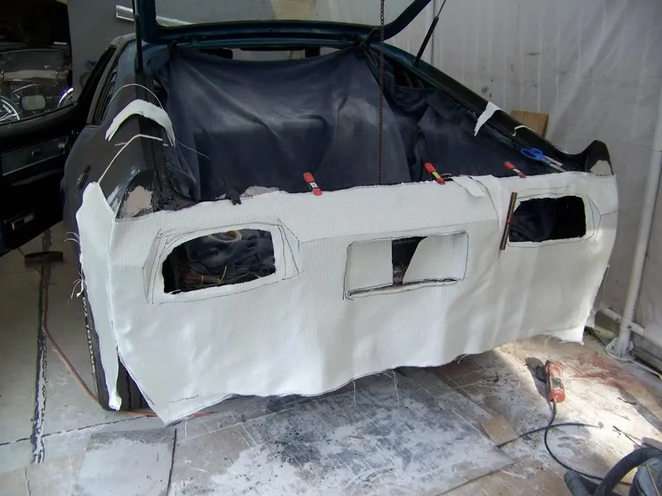

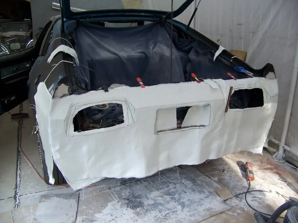

Glassed:
Rear with fin shortened and fiberglassed in place. 69 spoiler and pop open gas cap:

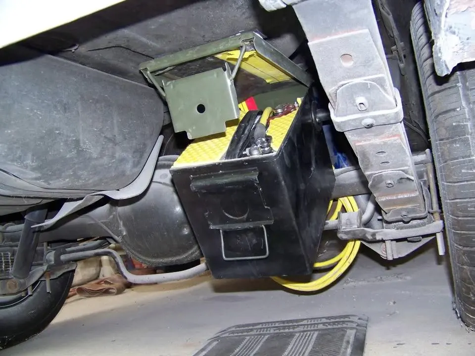

Unusual battery placement:

I like the front end, but the back end looks like it is missing something. Are you leaving it the way it is, or are you going to try to put a chrome bumper on to match the front?
I give you props for the workmanship, the work is great, it's got to take dedication and skill to do that. So good job there, but I can't say as I like the end results. I guess I am too much a purist, I like the II mostly the way it came. It looks like your trying to turn a II into a 68 or 69.
I traded the old outlaw wheels and I now have 5-bolt axles.
The back is rather corvette looking without any chrome steel but I haven't come up with an idea that I like.
The 69 Mustang Mach I is my favorite and the influences are apparent.
I got my fiberglass roll pan from a boat guy in British Columbia and I don't recommend him. He over charged and it didn't fit well. But Scottrods in Ohio has a great price on a better fitting one and even has a "bumper molding shape" built in.
