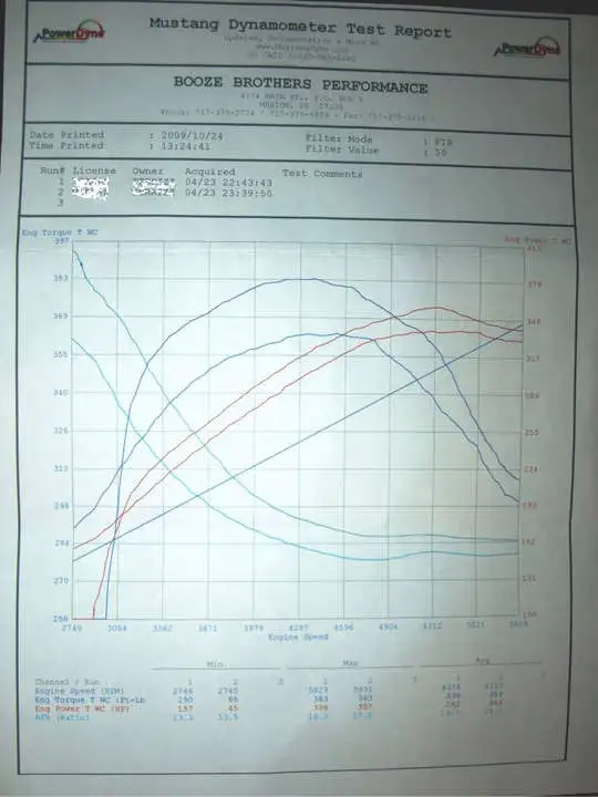

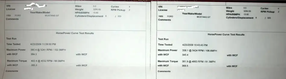

hey rick just turned 20 thousand miles on motor shes running great! motor is very streetable! here is the mustang dyno results

Decent numbers. What's the consensus on the Trick Flow 185's vs. The AFR 185's comparatively. Are users finding one makes any more power than the other? Is one of them of any better quality (valve train components, machine work, etc) than the other?
