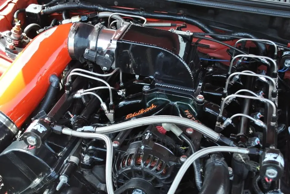

Here is a little nitrous inspiration:
And a sound clip:
YouTube - 2004 Mustang GT walk around and exhaust clip

That car is sick. Do you know what cams those are Nick?
And a sound clip:
Hey, I took that picture!!!
Jerry's GT is a mean son of a bitch... it's too bad he doesn't post over here. That's a mod motor car done right.
