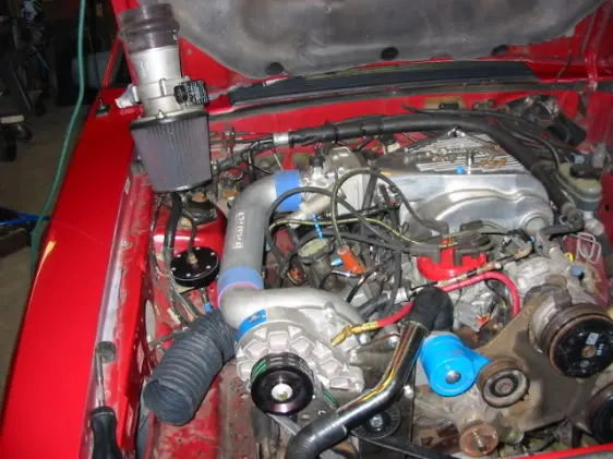

im not sure about the maf, but when i took the s/c off i had to make my own cai, i ended up using 3" pvc and it ended up working fine... its not like that any more i eventually put a pipe on that had a hole in it, which i might use for dry-shots of No2..
That's what I've done now. I should get a pic... I took out the smog pump, so there's plenty of space, I routed 3" ABS pipe down and the filter sits just below the air deflector... there's no way it's not getting cold air lol.
