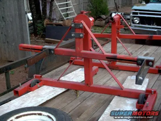

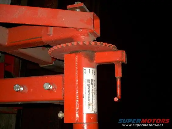

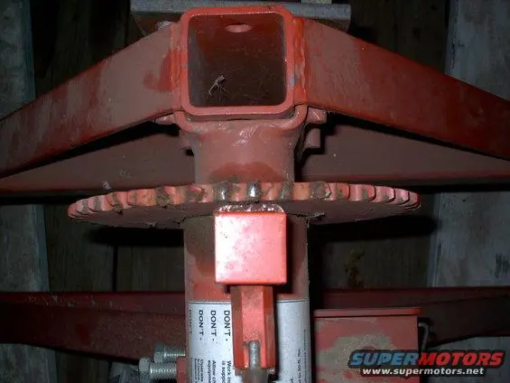

Here's a couple pics of my Whirly Jig. I welded up the teeth on the gear, it's as good as new now. In the 1st pic, you can see that the base has the outer tube and the part that raises has the inner tube, this is why I'm talking about putting a screw actuator inside there. I'd use a couple of extension cords connected to a switch box that has an extension cord to a wall, it'd be sweet.
