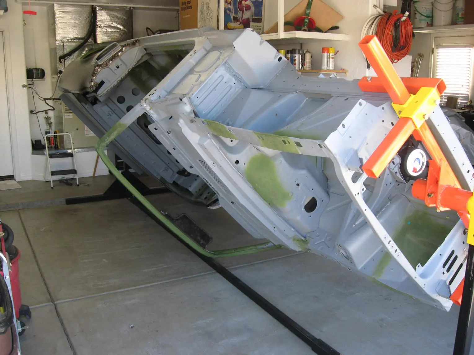

I Built a rotisserie this weekend. I only have a couple of pics but here you go. I will add some better ones once I get a new battery for my camera. Please pardon the messy garage. Who really has time to clean anyway.

Mine has some holes just in front of the rear spring mount. I hooked some angle into them. I will post a bunch of pics as soon as my Battery for my camera comes in.
You should post some pics of your rotisserie too.

This turned out pretty good. On the 3" uprights I would use a Tighter fitting square tube. Something more like 3" OD Receiver hitch. That the 2.5 would fit a little tighter in or change it to 2.5 OD Receiver Hitch with 2" Inserts.
I will add a 3/4" Thread all to move the car up and down to get the center of gravity on it. I drilled hole every 2 inches on one of the Hanger t's. It was a waste of time to drill all of these holes. I am only using 1 of them. Instead I should have used a pinch bolt to get it where I wanted it and then drill 1 hole for a safety bolt. Then mark that Hole 1969 Mustang.

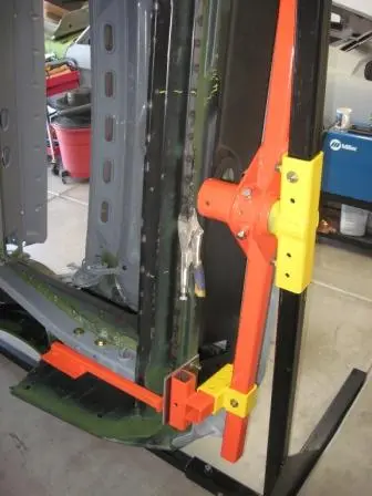

Hi, I'm not the same guy, but here are a couple of photo's of the rotisserie I built. It looks like I can only upload two photo's.
