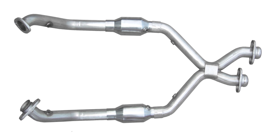

It's close, but the cross over is different. Honestly, that's a good price and it's a hell of a lot cheaper than it used to be.
I'm not sure how different it could really be. Both are setup to accept the cat-back in the stock locations. The sliders for the headers give you a little room if needed but also pick up the headers from the stock location. The last Dr. Gas that I saw was regular steel and I think had ball flanges for the x-pipe. It was still in the box, broken into what looked like similar pieces to the Anderson pic.
Looked like this with a bassani stamp on the x and iirc it was close to 700 dollars about 10 years ago.
