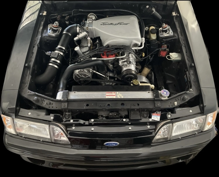

Hello gentlemen,
I have a question for ya’ll
I think I had enough of those pesky exhaust fumes after years running without the air pump and the entire anti smog system. Besides that I removed the secondary cat converters, at one point I removed the upstream cats and it was horrible so I put them back on.
My question is can I run all four cats without the air pump? Or, if I decide to have all the cats can I run continue air flow to the downstream cats? That is installing the air pump running a straight hose to the pipe that goes to the H pipe having a constant air flow.
I’m just trying to remove that bad smell out of the tail pipes…
I read that those secondary cats will get clogged if no fresh air comes from the air pump. What about running fresh air constantly?
Could anyone help with this issue?
