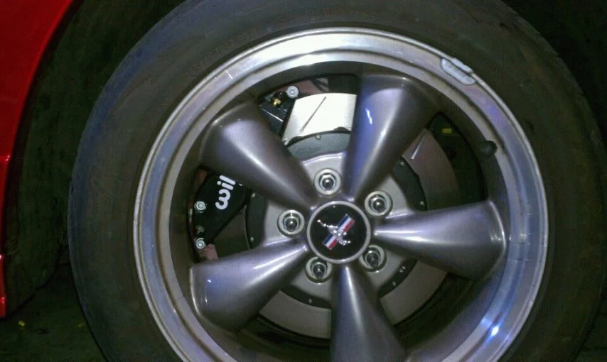

Does anyone have any pictures of the stock 17x8 Bullitt wheels on 3" wheel studs? And also 17x9 & 17x10.5 Cobra wheels (03)?
And does anyone know if ARP makes stock length studs for 99-04?
I had 3" studs on my american racing torque thrust IIs, but I marked them and then used a cut off wheel for the custom length I needed. If you do this be sure to thread a nut onto the stud before cutting, then unscrew the nut to clean up the threads.
Best pic I've got.
