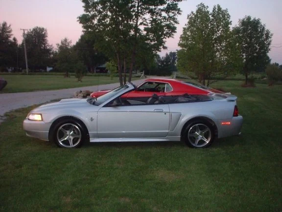

i have it. installed it in my driveway. for the price, theres no way you can beat it. however, the drop is nothing big. 3/4" is about the max you'll get i think. i noticed less body roll, not really much difference in how the car handles potholes, etc.
this doesn't quite do it justice, but i think it's the best pic i've got at the moment. i got a 1 1/8" drop. just about what it should be from the factory. if you are looking for the slammed look, you won't find it here.

No, i definitely don't want it slammed, but i want something lower than stock.
Too many potholes here in MA to go to low. That's why i'm looking at the bullitt kit. It's matched, lower but not slammed and something used from the factory so it will still ride nice
