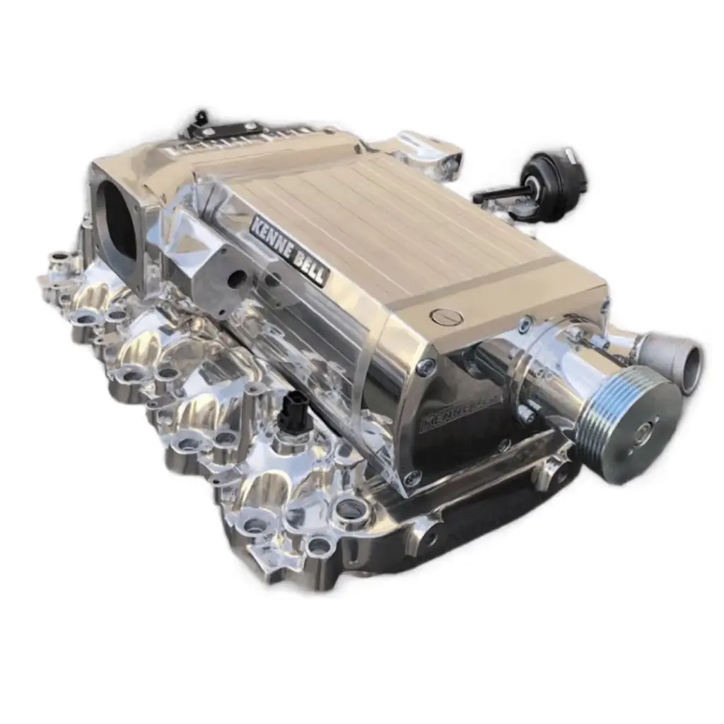

Slap one of these on there and keep [all] the street manners and push your current torque and HP numbers, [up] by 200 hp/tq:
1999-2004 4.6L RWHP GAINS​
+160 hp (65%) @ 9 PSI
+204 hp (83%) @ 10 PSI
+262 hp (+107%) @ 14 PSI
You keep all your factory stuff including gears.
For tuner kit, you need the SC kit, fuel pump(s), injectors, and a tune.
They can be hard to get these days so, if you ever decide to go this route, be sure to call them about availability.
