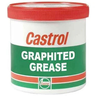

You’re supposed to use graphite Grease on polyurethane bushings. Anything else will squeak the moment the grease wears away a little. :)
