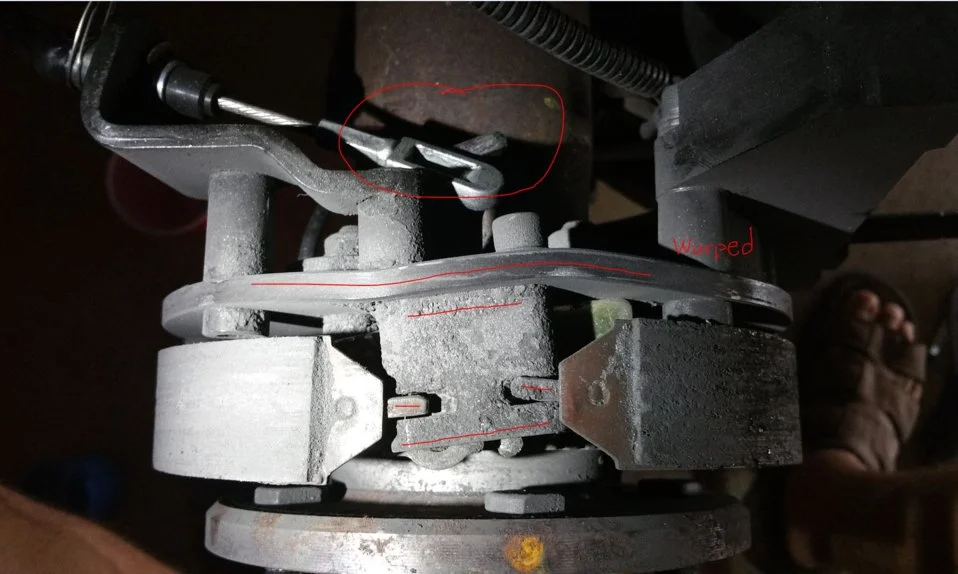

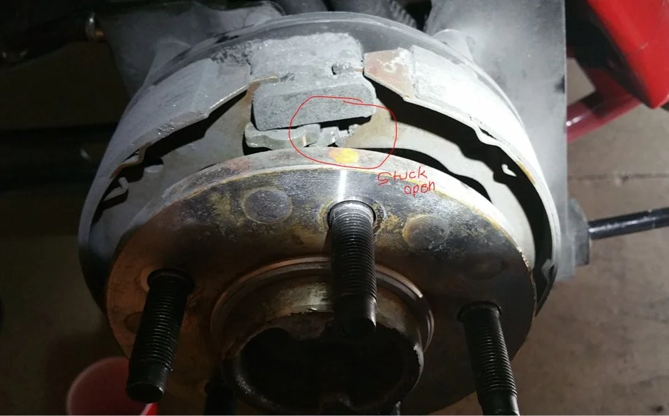

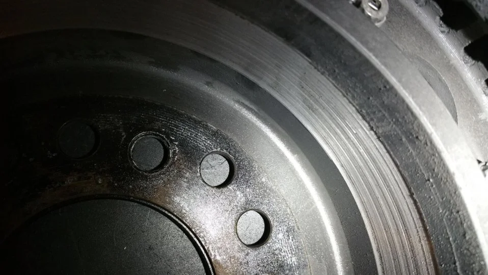

Next morning I drove the car to work and noticed that the rear of my car was making all sorts of grinding noises when I made hard right turns. Once I got back home after work I took the rear wheel and brake kit apart to figure out why it was grinding, and to my horror I found that the parking brake assembly had completely failed.
The brake pad shoe rest warped the aluminum backing it was mounted to, causing a misalignment of the parking brake shoes that caused it to grind against the parking brake drum. I contacted Wilwood, and some snot nosed kid there told me that this has never happened before, and accused me of installing it improperly. I asked him to put his supervisor on the phone, and he told me that he was unavailable. After this it got heated and I got nowhere. I hung up with him and wrote an e-mail to Wilwood telling them about what happened to me and the ridiculous response I got from their tech support agent.

I forgot to add when I got to work I pulled the parking brake and handle was loose and did not engage the parking brake. This failure caused the parking brake cable to detach on its own. I'm sure someone at some point is going to have a mustang roll down a hill because of these flaws.
