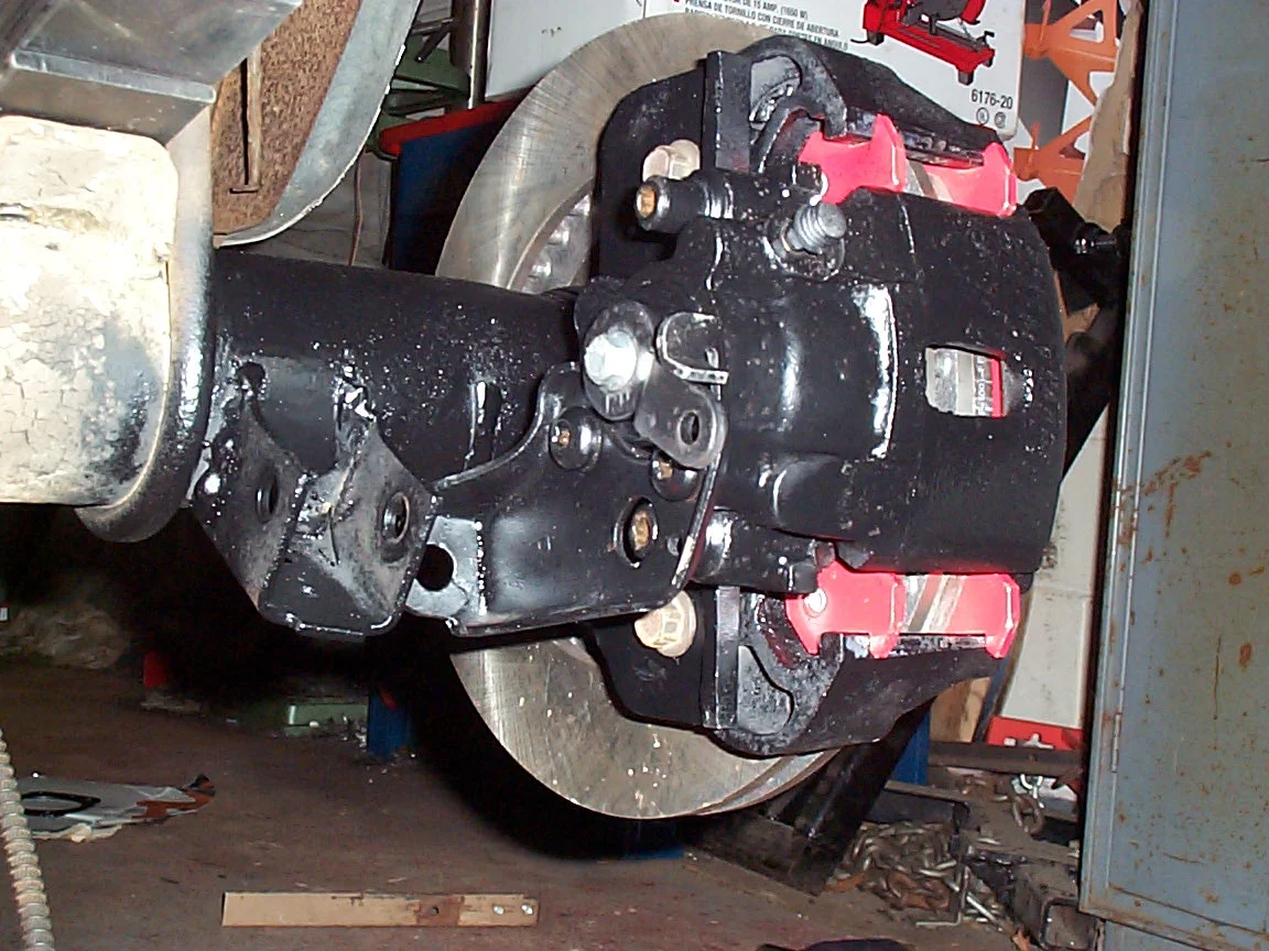

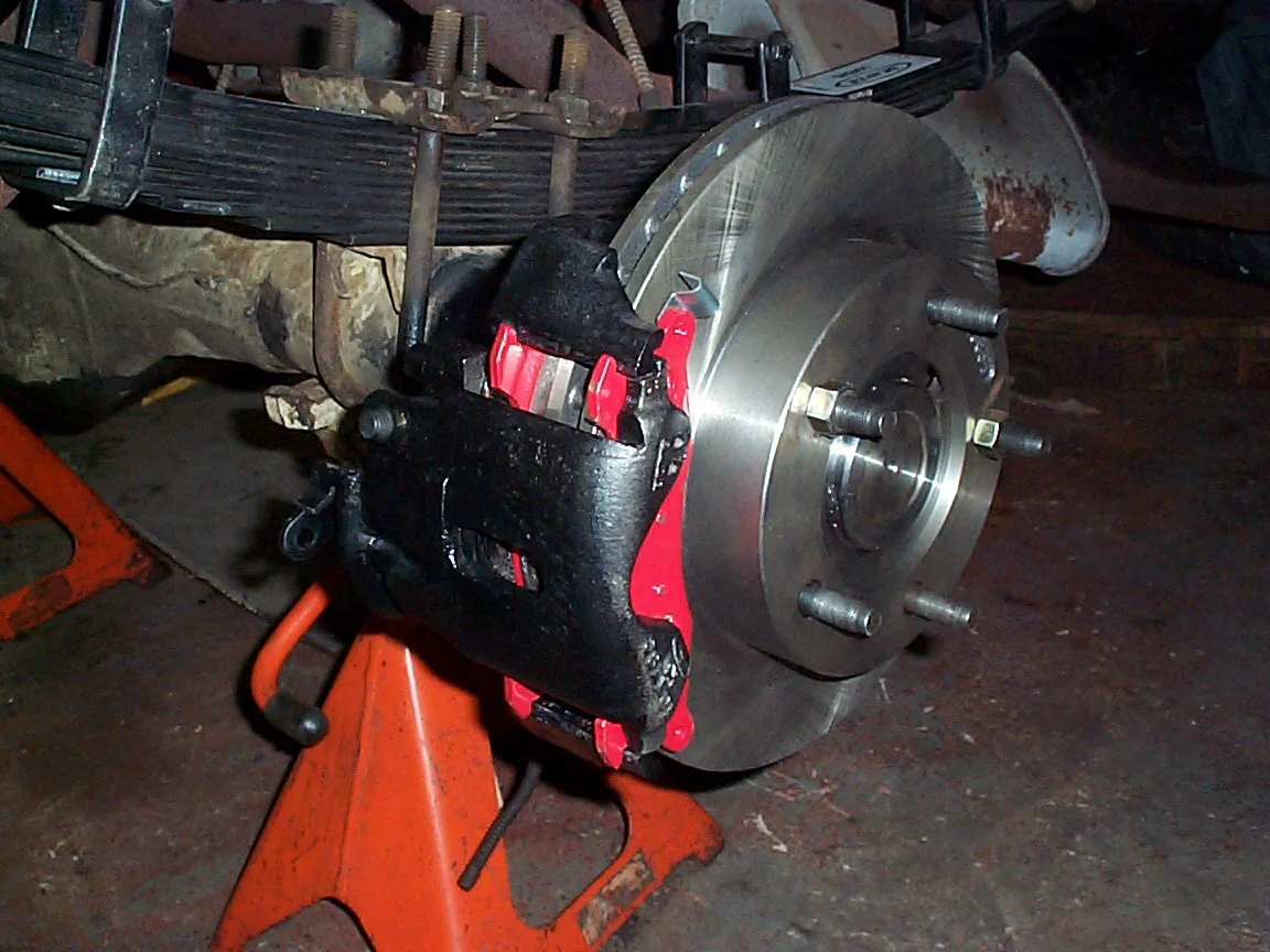

Not sure what options are avail these days to use a cable operated emerg brake caliper, but
I went with Mk VII stuff on my 70 bronco. Used jeep wrangler front rotors, IIRC.
Did have to weld on my own caliper bracket.

but there has to be a reason why they work on a Granada but not when transplanted.
I did the swap into early mustang 30 yrs ago but parking brake was always lack luster.
So hard to remember pertinent info.
That damn Ver-silly rear parking brake was operated by a foot pedal with about 8 to 1 ratio
Mustang brake handle is hand operated at about 4 to 1 .
Also
needs a master cylinder that can push a bit more fluid to rear.
and was an issue with the parking brake cable angle.
