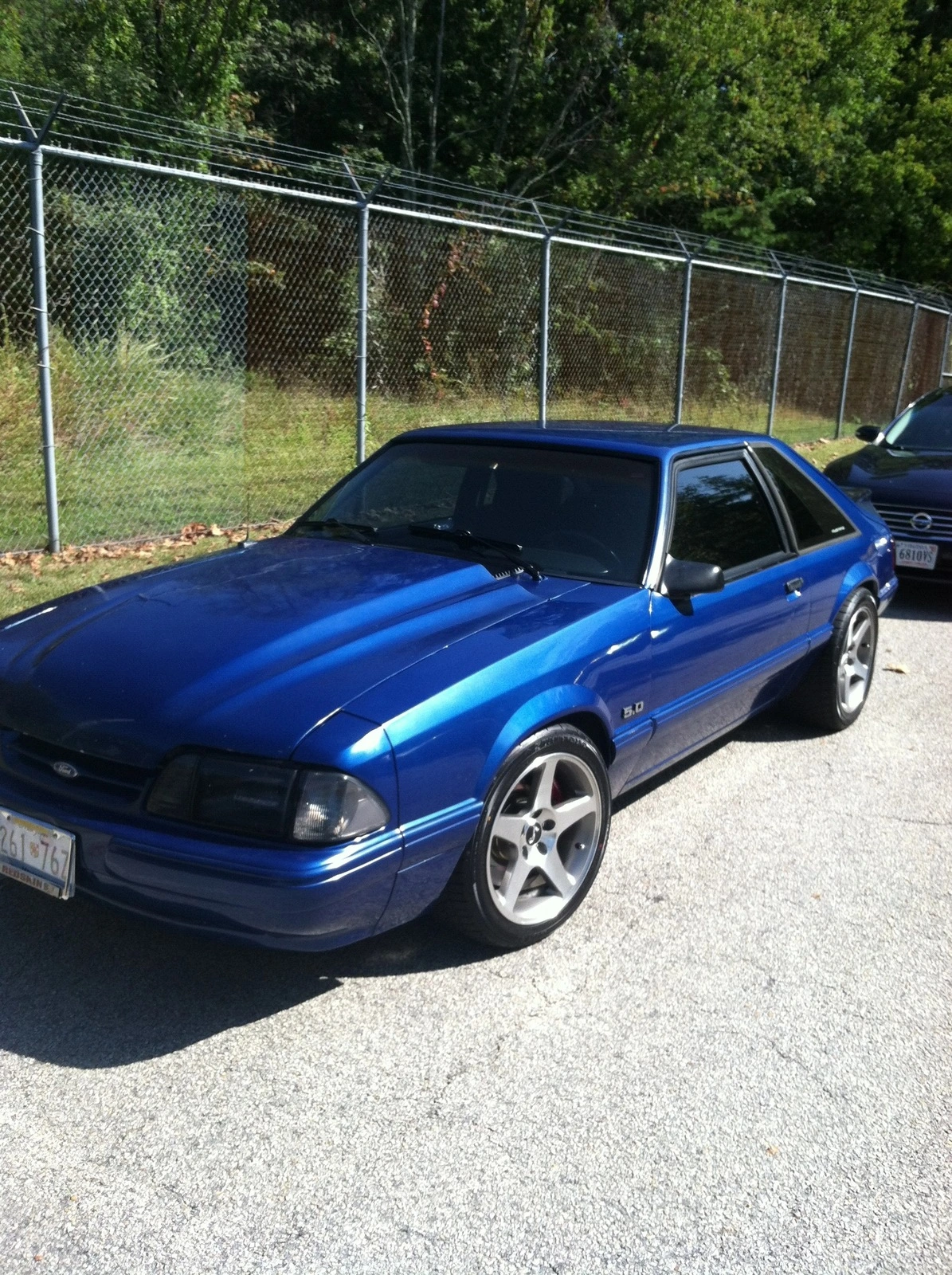

I understand what you are saying John D, I too bought an "orphan" that needed lots of work. I have probably spent about 8k in making it what I want. I didn't care about having a low mileage car and my goal was similar to this guys. I think my turn out worked out well for me. He has a vision and his goal can be obtained.
Nice man. What color is that?
