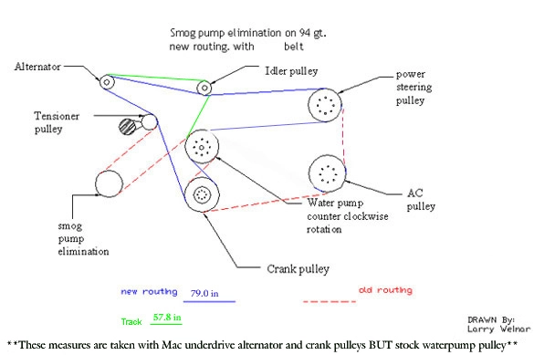

Peep these diagrams. Im actually bypassing the smog pump and AC because they began making noises, im even bypassing the idler pulley. Im running a 80"-81" belt. I need to find just a tad bit shorter belt, like a 79"-79.5". Sometimes the belt tensioner begins tapping itself since the belt needs to be a bit shorter.
Seems to me the wp is not gonna be as efficient turning the opposite way.
Has this method given you any probs with keeping things cool?
Grady
i run the setup bypassing the smog ac and idler pulley, and have had no problems. The idler does tap when idleing though, but the belt is still tight enough and does not slip. when i go home i can get the part number for the belt, i got it from autozone.

5.0_GT_kid said:
Musti81 thanks alot...that second diagram is the one I needed!
No prob man....its what we are here for. I never had cooling problems. My car always stays between "O" and "R". The only reason im bypassing the idler pulley is because i couldn't find a belt that would fit with it. The extra belt slack taken up by the pulley made it hard to find a belt that would fit.
