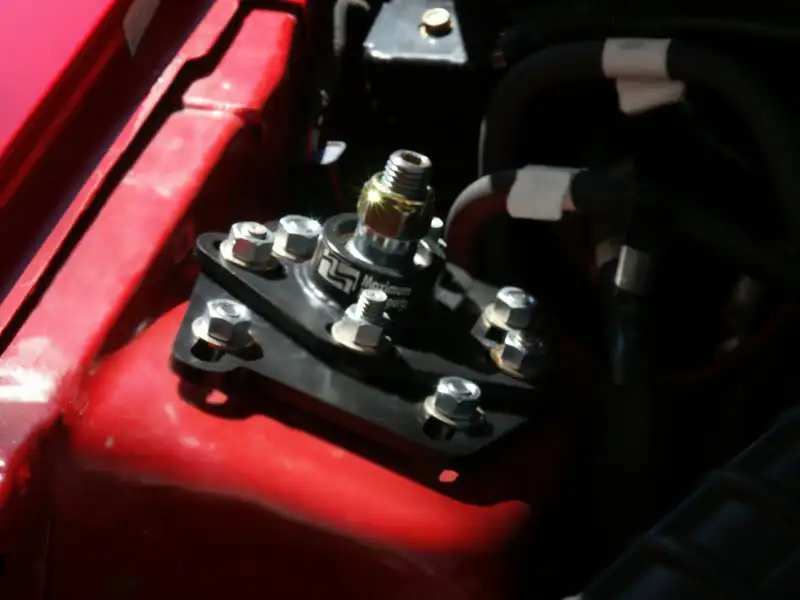

2"...? You'll need them, otherwise you're going to eat your tires alive in no time. The Maximum Motorsports C/C plates are nice. That's what I have. You need them if you are going that low... period.

get the maximum motorsports 4 bolt c/c plates and an alignment

MM 4-bolt CC plates , the CC plates will give a greater range of adjustment for Caster and Camber than stock plates do.. Some people can get away with out CCplates because everyone one of our cars are unique and sometimes maybe you can get your camber correct with out the plates..But most people find that with a drop 2 inches most people will need to add CC plates. 1.5 or less usually will not require CC plates. Besides your tire and aligment tech will alway love them..they make for very easly alignment.
