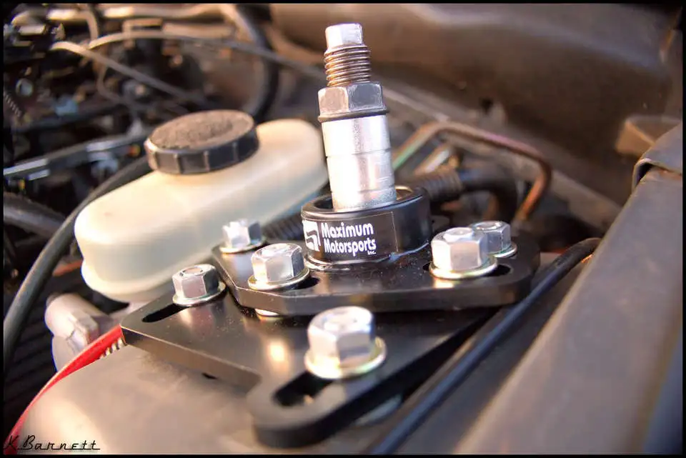

INVERTMAST being the cool guy he is helped/installed my Maximum Motorsports Caster Camber Plates and my Strante 10-way adjustable Struts.
um those spacers are suposed to go under the caster camber kit. They slid onto the shaft and then the shaft goes through the caster camber hole. Finally, the nut screws on.
From the MM website..
Important
Important - At least one spacer above the caster camber plate spherical bearing is required to allow proper movement. Failure to do so will result in limited bearing articulation and possible damage to the bearing and/or the strut!
Riley
most people are too dumb to realize that you have to put the spacers ON TOP when you lower the car, i think i could have gotten away with using equal spacers on each side but the car is just under 2 inches so i played it safe...
C/C wasnt too terribly hard, struts were easy and i need LCAS lol
if you wish to shorten your available suspension travel by leaving the spacers on bottom, by all means go for it, but unless you dont trust what a suspension company as well known as Maximum Motorsports you should do it the way i have it.

do you have an issue with the top of the strut contacting the hood I know with mine i had to move one of the spacers down so the hood wouldn't contact?
yep, makes all kinda noise right now too... i plan on having to dremel out some of the hood, or move one spacer down as you said, i might do that just to make it easier for everything, and possibly give me a bit more travel for those drag launches :)
I don't think dremeling out a notch in the hood will hurt anything as long as you chamfer the edges of the notch you cut out. I don't have any issues with shock bottoming and its been like that for a year so i just left mine alone.
I went 50/50 with 2 spacers on the bottom and two on the top..
I have Bilstiens with FRPP C Springs.
So far so good and it's 3000% better than what I had before when I didn't have the C/C plates and spacers to change the bump travel..
