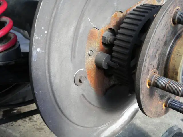

Did you remove the ABS sensor?
The ABS ring doesn't come close to the housing. The axle housing is the same for Foxes and sn95s.

Stang&2birds;
True,the ABS ring doesn't come close to the housing.
You must remove the ABS Sensor before pushing in the axle shaft,otherwise the ABS Ring will contact the ABS sensor, preventing the shaft from being pushed in enough to remove the c clip.
I also have the m2300 kit on my 94 gt.
This may be his problem.

davis3 said:
Stang&2birds;
yup totally my problem. I would have bet the house that I had taken them out. I did take them out...out of the front spindles. I had the rear end on saw horses with the diff cover facing up. Couldn't see the sensors...dumb a$$
