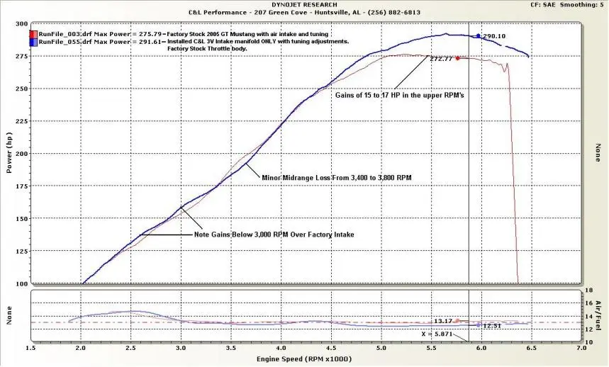

Ok, so attached is the dyno graph of the new manifold as tested on BAMACHIPS' car. I reached out to them for a tune, and wow is their customer service the best I have encountered...
Anyways, not to get too off topic, looks like some decent gains. THe graph is a stock gt manual with racer intake. Thought I'd share with yous :)

Doug at Bamachips is a great guy with great results (for me and several others in the area-dyno tune). The intake does have decent gains and at least on the N/A application holds true to only a noticeable gain in the upper (4500+) RPM range. Great for the track, but little help on daily street driving, but nice to know it's there.
I have been talking to Doug at Bama for weeks now about this. We have to be patient. Neither Lee at C & L or Doug want to print false numbers. They are taking the time to test multiple runner lengths to find out what is going to give the mustang community a quality piece. We just have to wait a little longer. Doug is going to test again this Friday on his own car which now has cams and headers. So let's see what happens.
