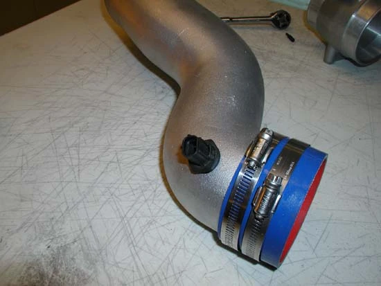

The 96 to 01 has a hole in the tube near the MAF opening with a rubber grommet (not the other end where it connects to the TB). This is for the IAT, which, on the 02-04, is integrated into the MAF and therefore not needed (not as a separate piece).
Here is a pic of the 96-01 tube, close up, with the IAT in the hole.
