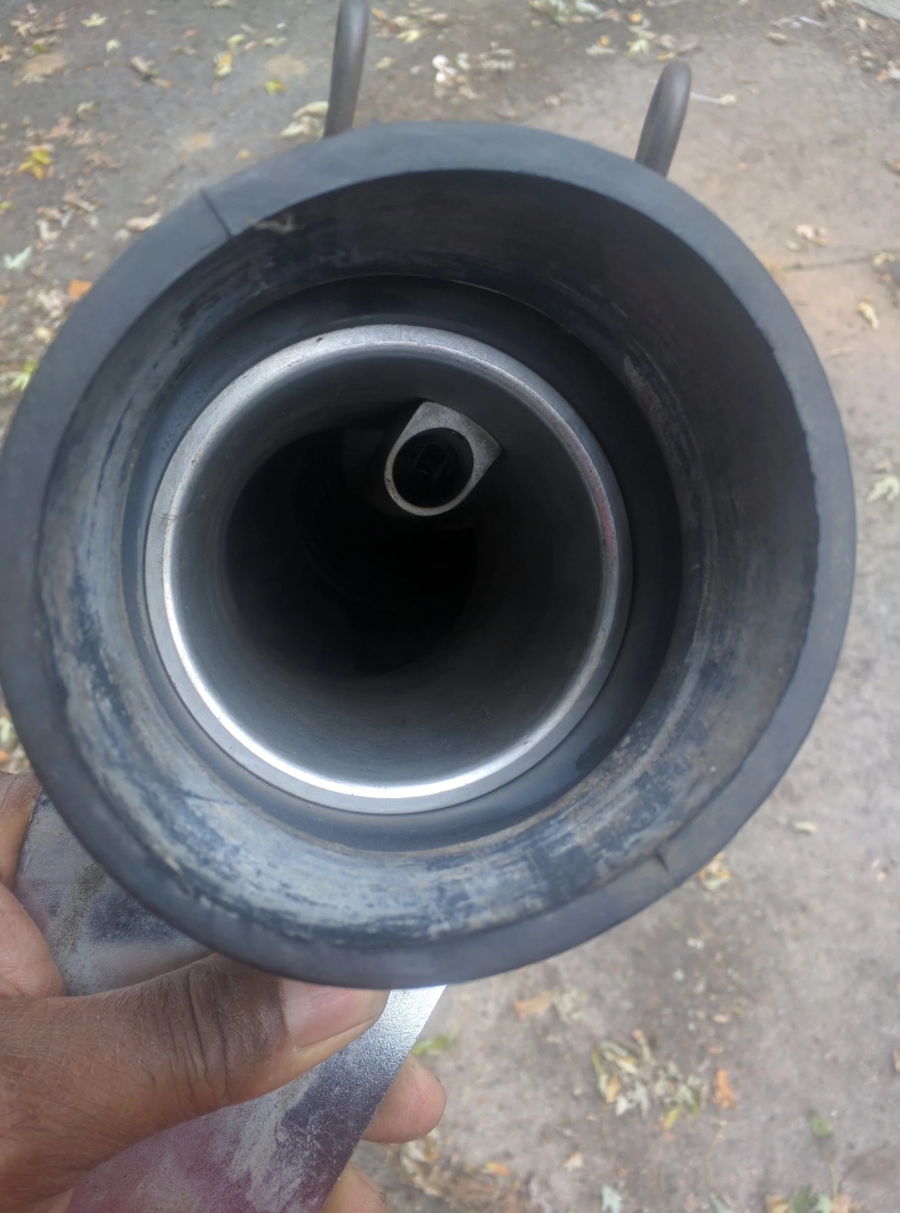

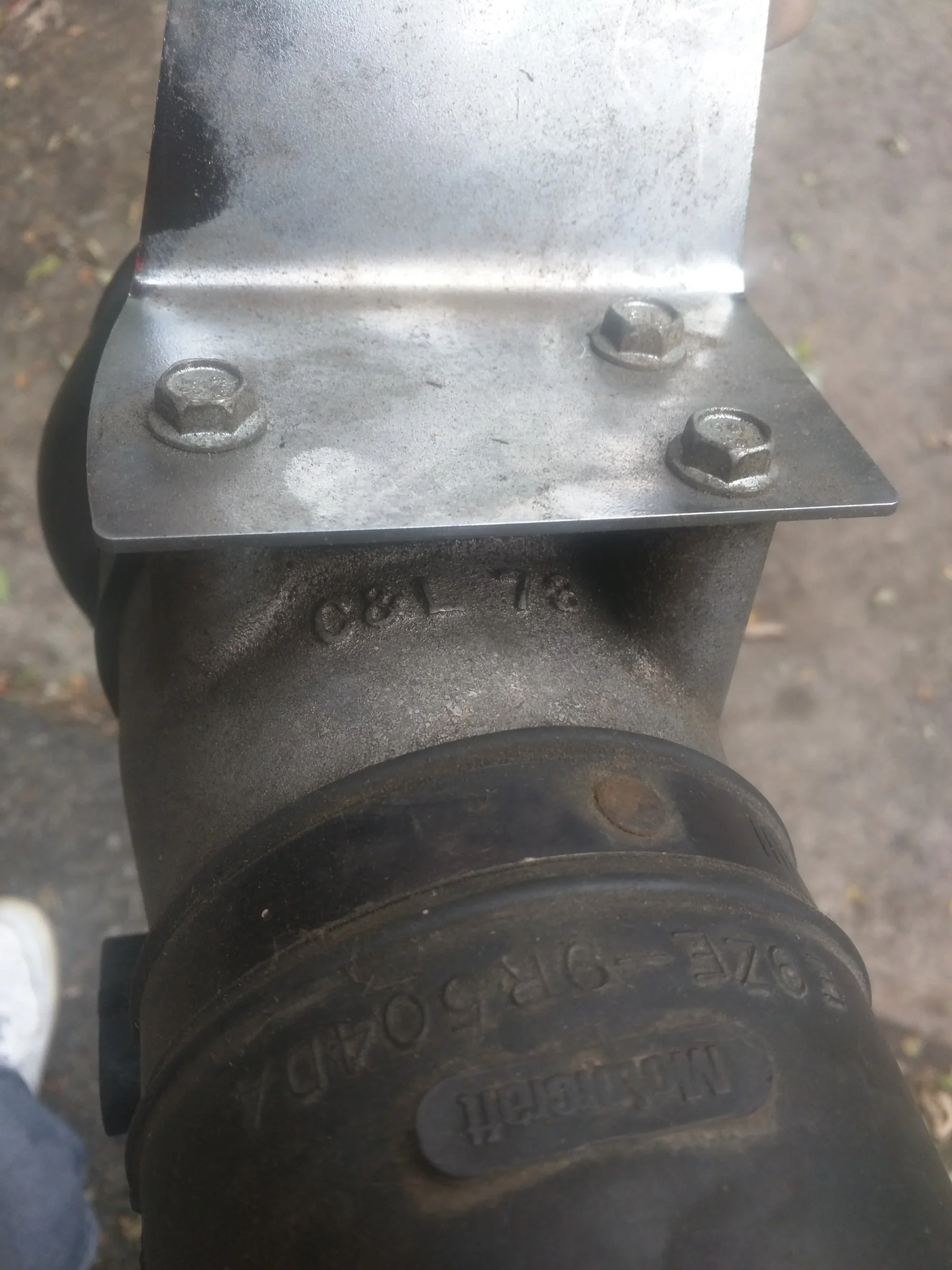

I have found a C&L 73mm mass air meter in my garage. I don't know how long I've had it, but I was wondering how can you tell what size injectors it's calibrated for? My engine is stock so I guess I have stock injectors.
So when it said "clear tube" are they referring to the aluminum looking tube in the center? I was reading and I was wondering if the center diameter of the little tube is what they meant.? Or is there a clear/black tube hanging inside the small removable aluminum tube?

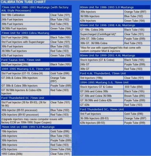

The smaller the tube the larger the injector size. Here are some tubes for example. It appears what you have is a 19# size
Color code - Inlet Diameter - Outlet Diameter
Green ------- .6500" -------.4850"
Black --------.4880" -------.4880"
Red ----------.6570" -------.5125"
Purple --------.6500" -------.5400"
Blue ----------.6500" -------.5550"
Clear ---------.5650" -------.5650"
Orange -------.6500" -------.5700"
