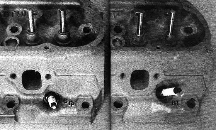

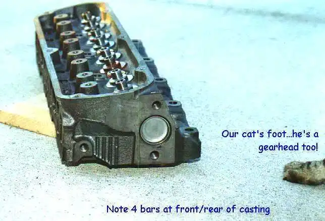

The 1990 Mustang heads (E7TE casting number) really arent the greatest either, but probably an improvement over your original heads. Some clean-up porting on the intake and opening up the exhaust a bit will net you a world of difference. Or just get a set of gt40 cast iron heads. Approach gt40P heads with caution as they have a relocated spark plug angle that can interfere with headers. I believe the stock manifolds clear the gt40P spark plugs (somone correct me if Im wrong here), but the early gt40 (no P) have the old plug angle and flow much better than the E7s. A good set of used gt40s will set ya back less than $400, so in my book theyre the best option for a mild performance engine. If you decide to go this way, these pics should help you (or anyone else) identify the different heads.
4 bars = GTP
3 bars = GT
