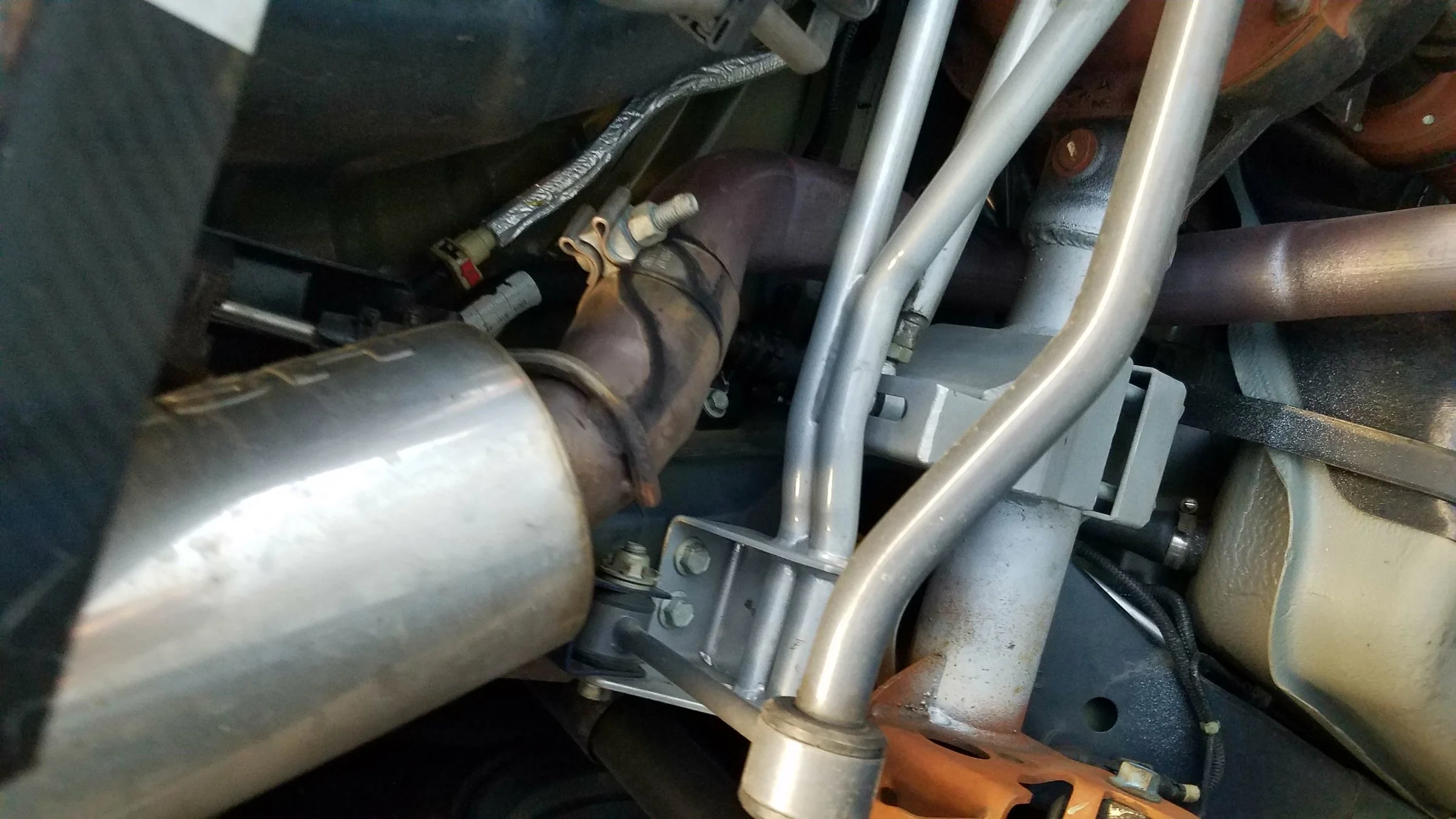

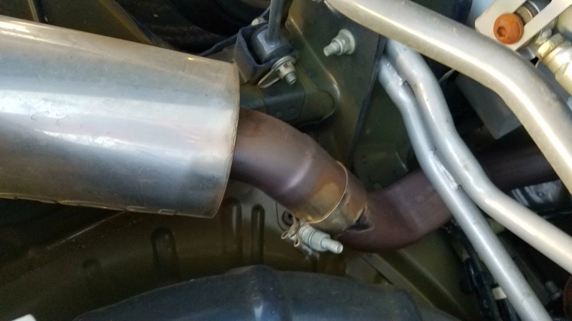

In a couple of the pictures that I'm going to attach you can see where the exhaust goes up over the axle, there's a pretty good kink in the pipe, is that just how it was done in 2008? or is it still that way today? I was under the impression you wanted your exhaust to flow as unobstructed as possible, will I need to get a new full exhaust to fix that?

I'll begin your thread my mentioning that your exhaust is a tuned-exhaust. You should monkey around with unless you're monkeying around with it as a complete system. The MOST you should do to your exhaust without research data to back it up is a cat-back. Otherwise, you should be looking for a complete exhaust solution and not just pieces and parts. The wrong exhaust can just as likely to kill performance as enhance it and many folks end up going the wrong way.
