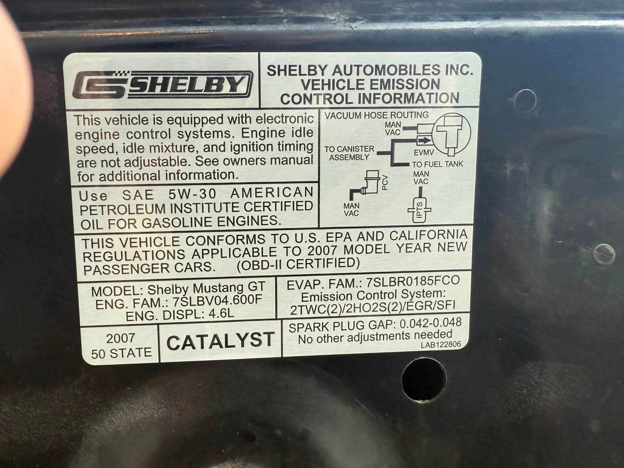

My issue is that I went to get it smogged, and I failed due to the EGR being removed/tampered with. After doing a ton of research, it looks like the 3v 4.6 does not have EGR. I tried to explain this to the smog tech, and he pointed to my Emission label under the hood, where it has EGR listed.
Could this be an error, or were the Shelby GTs made a little differently? I am leaning toward an error, as I looked at every engine bay picture I could find of a Shelby GT and could not see an EGR valve. Also, every manual I downloaded or parts catalog has no mention of EGR for the 2007 GT.
Any help would be appreciated. I am attaching a picture of the label. Thank you.

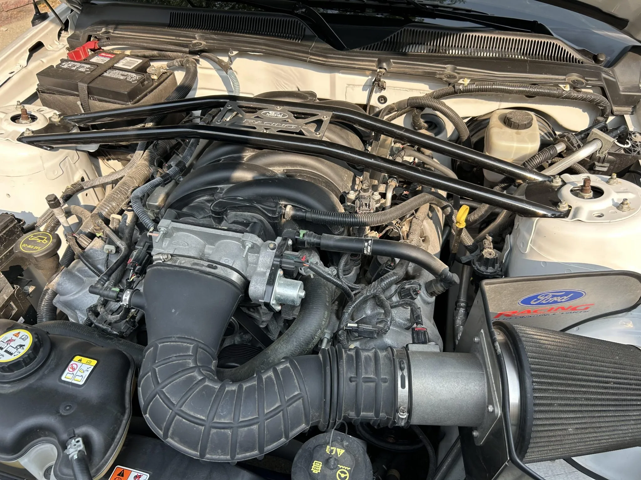

Thank you for your help. Looking at a bunch of normal GTs and searching through threads I find people saying 3v 4.6 no longer have EGR.
I found a bunch of examples on Bring a trailer of the same engine bay and could not spot any differences between mine, other Shelby GTs and other normal GTs with respect to the EGR.

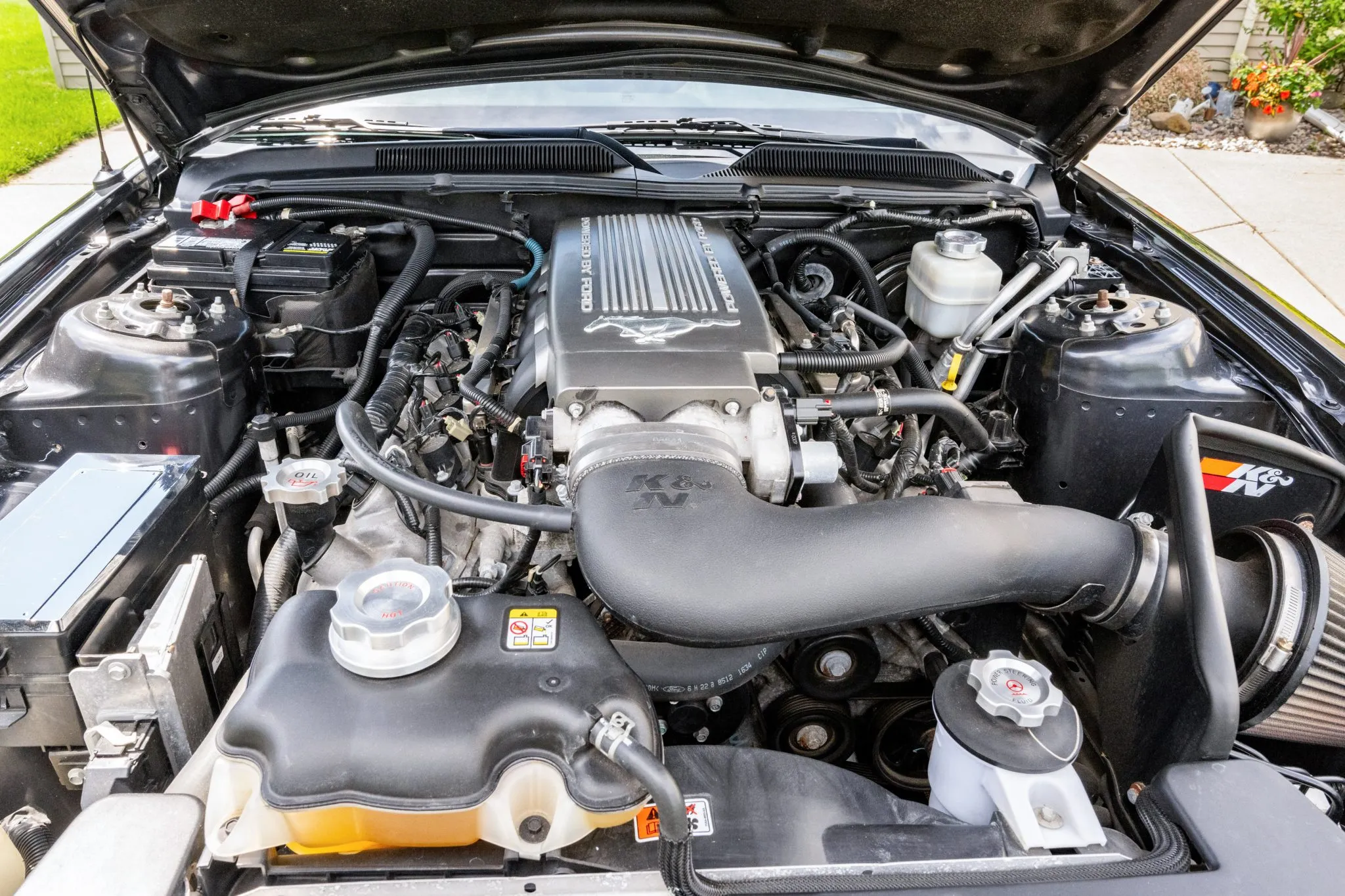

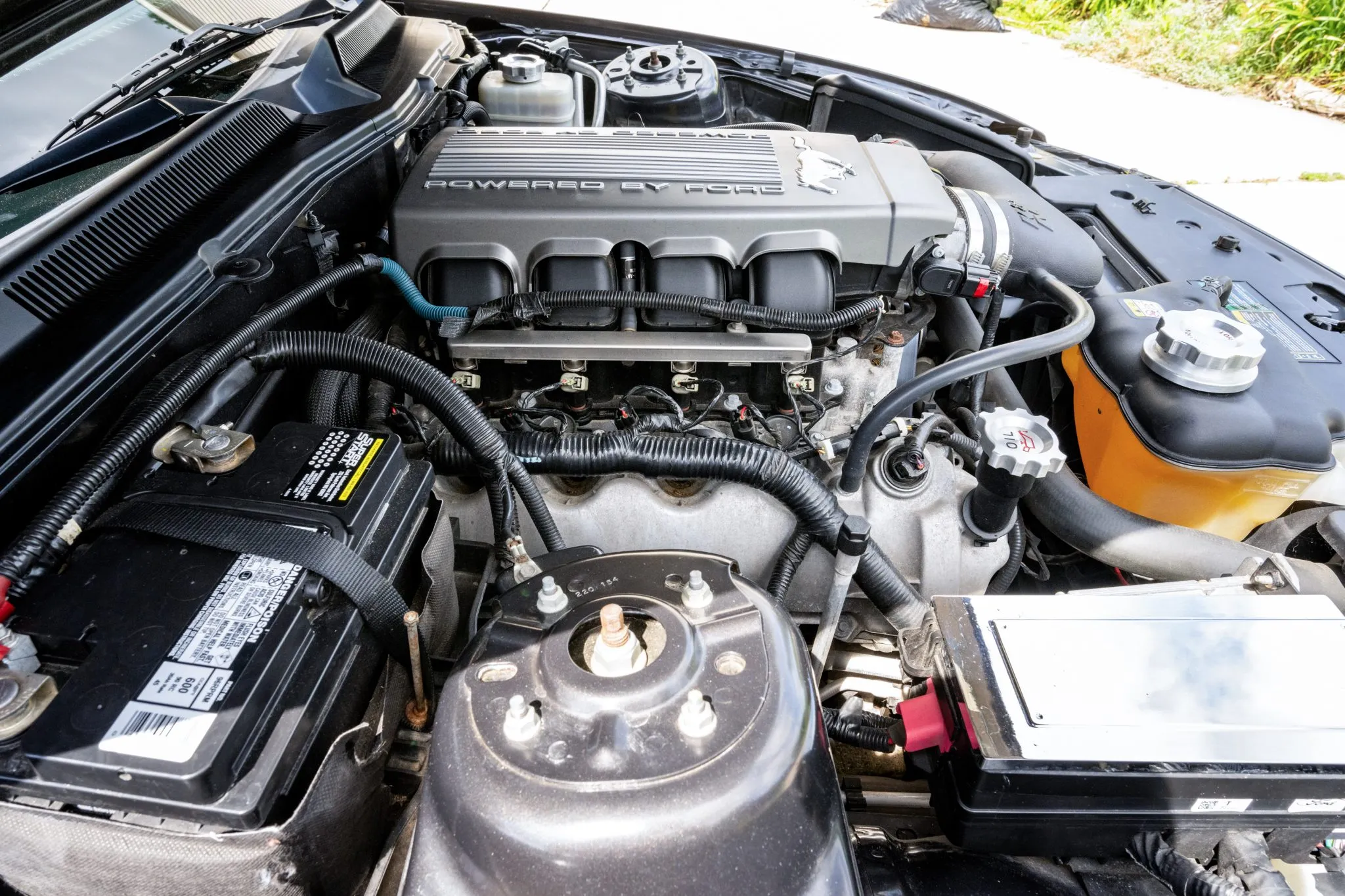

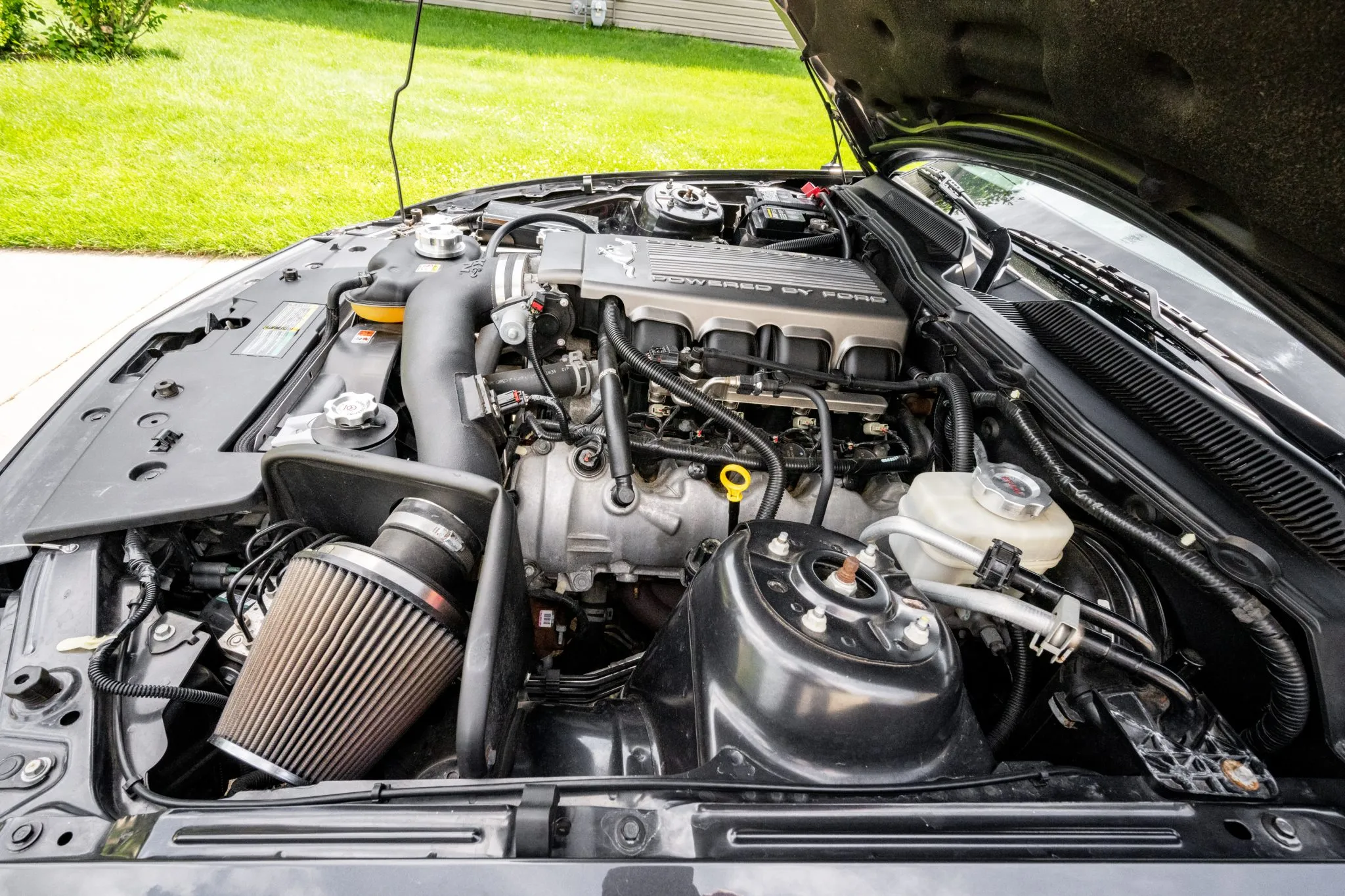

Here are a few pictures of a normal GT
  • 2007_ford_mustang-gt-coupe_2007_ford_mustang-gt-coupe_742ca0fb-eea4-4f04-85b3-32d7f0d52f8f-MN...webp

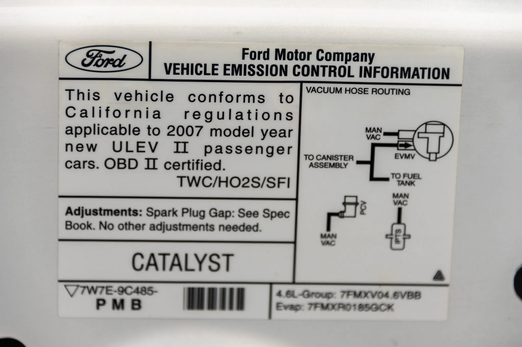

other threads for reference as well. This rabit hole I'm going in is deep lol. I even found VEIC labels from same-year GTs that have no mention of EGR.
The label attached is also from a 2007 GT.
  • 2007_ford_2007-ford-mustang-gt-california-special-convertible-5-speed_2007_ford_2007-ford-mus...webp

I do not see where an EGR is [indicated] of any of those tags. :shrug: Do you?

I was failed for “removing egr components” that never existed.
Spoke to a state ref and now they are saying I need to install it or it’s possible my engine was changed and they want to treat it as an engine swap all because the emission label list egr.
This looks like a mistake of labeling on Shelby’s end.
