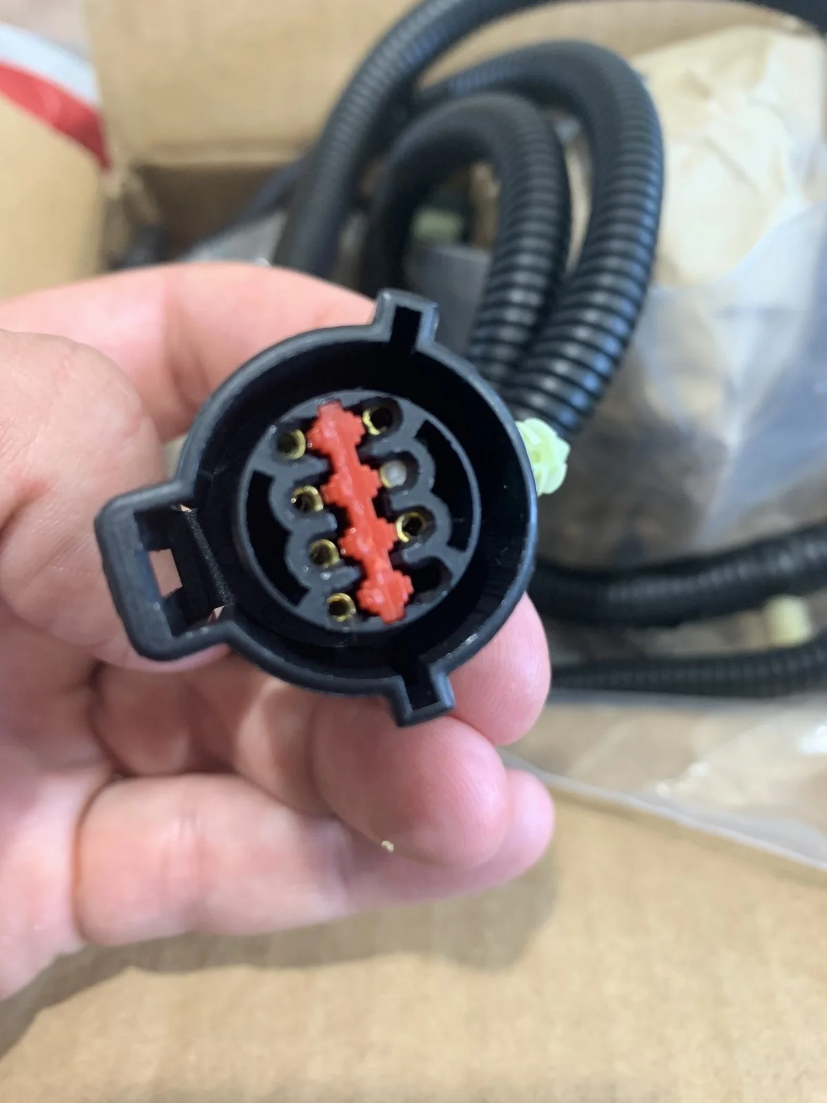

U sure that's not connector grease?
Yeah, in person it has a ledge to it like something was there that was snapped off, and i dont want to try pulling that piece out and damage the harness. I sent them the picture and Kris said he was going to check and see what could have happened or if its something that im supposed to remove. I just dont want to try pulling that out and get stuck with a unusable harness and money down the drain

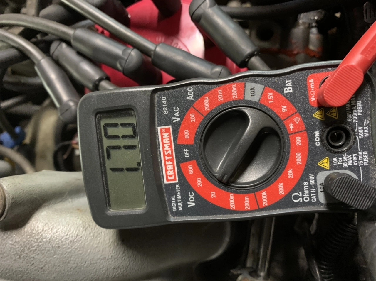

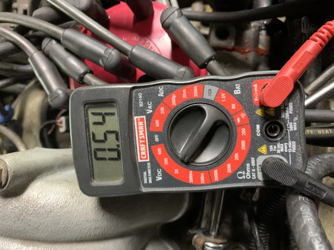

I meant to run codes but without thinking, I disconnected the battery after I double checked the tps to make sure that the computer recognized the tps was in range.
I also noticed I get different tps voltage settings depending on my ground. If I go to the post of the battery I get a really high reading, but if I go to a ground on the body, engine or the negative cable and not the post, I get lower readings
so right Now based off of the other grounds and not the negative battery post, the TPS is set at .88
You used the wrong ground to check the TPS voltage...
Why do the engine control sensors have a separate ground?
The computer pin 46 signal ground is a critical component: it provides a signal ground for the Map/Baro, TPS, ECT, EGR position and ACT sensors. Every sensor has to have a reliable ground for it to provide accurate and useful information to the engine control computer.
The more current that flows through a conductor, whether it is a cable or the car body, the greater the voltage drop. The ground on the car body and ground cable for the engine block may have different voltage drops. Some of the voltage drops change depending on electrical loads such as lights, A/C, and heater blower settings.
Under high current loads, there can be large changes in the voltage drop across the ground wiring that goes back to the negative battery cable. If the engine analog sensors ground is combined with power ground, the computer will see these changes in the ground as a change in sensor input. This voltage change is very undesirable for reliable computer operation, so the engine sensors all have a separate shared ground.
The engine mounted sensors all have outputs of 5 volts or less. Therefore, any small changes in voltage seen by the computer analog signal inputs can have a large effect in engine performance. Signal ground is used in many circuits that have analog inputs to eliminate the voltage drop across the engine block and body grounds when current flows through them. There is very little current flowing through the signal ground and the voltage drop across the signal ground is so small that it can be ignored by the computer.
The voltage output of any sensor must always use the signal ground for the sensor under test in order to eliminate any errors or variances. That way, what the voltmeter sees is what the computer sees unless there is a problem with the sensor wiring.
