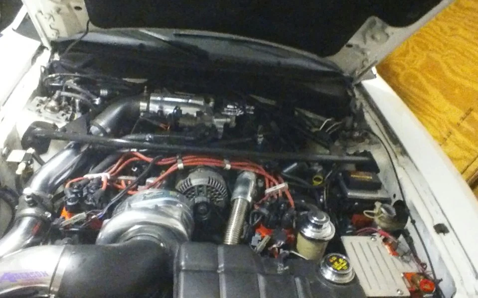

I hope someone can help . I picked up a 1997 procharged 4.6 a few days ago an the Speedo is off . The place I got it from said it has 4 10 gears . now I have talked with a few different people at American muscle one said Speedo gear the other said Speedo recalibration tool . Which way should I go ? Also do I need a handheld tuner for the car if I go get it dyno tuned ? It is running rich

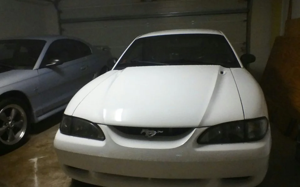

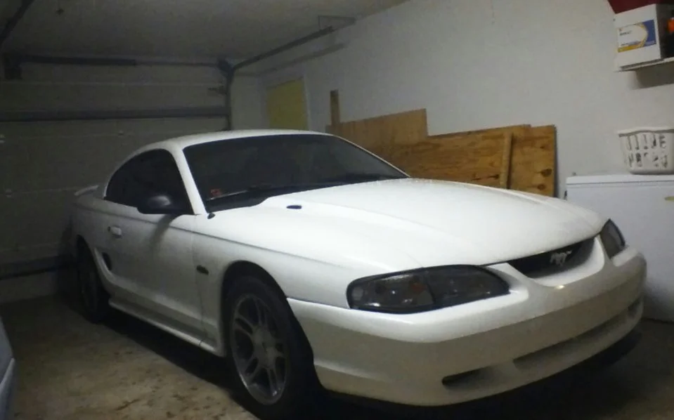

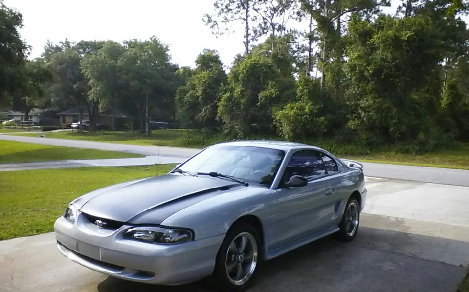

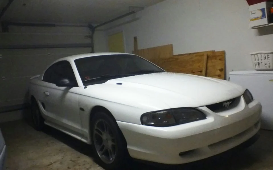

Thanks for the info guys .I'm real happy with the car I think I got a good deal on it . I paid 7500 and she's only got 54000 miles on her with the procharger bbk long tube headers, bbk 78mm throttle body,plasma booster,msd coil packs & wires . The place I got it from (rpm motors in west palm beach fl) said it has 410 gears,forged bottom end,built heads and a stage 3 clutch. Don't know if what they said is true because they did not have no proof of that stuff. I do know that the boost gage reads 8lbs at 5000 rpm . I have only taken it to about 5500 rpm in 3rd gear an was stuck back in the seat. I'm not gonna get on it to hard intill I get it on a dyno. Fingers crossed for over 500 hp. what do you guys think ? Also I could not talk myself in to selling my six banger . She's not fast but she looks real good . Now my wife has named them beauty and the beast .
