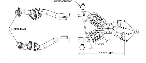

The only reason it is California specific is that it has four cats, instead of most other's two. If that's what you want, it will work fine, but will probably give up a couple of horsepower to a two-cat unit.
The factory pipes do have four cats, but most high performance catted pipes only have two. The Magnaflow part uses four high flow cats to meet California's standards.

The MagnaFlow 93332 only has 2 cats, I know because I bought that system in 04 when it came out.
At that time the 93332 with 2 cats and X pipe also came with the EO# D-193-14/8-7-96 so that you could pass emission testing in Calif and was acceptable for use in Calif until 2009.
Calif changed it's law and said that if the OE system came with 4 cats you needed 4 cats to pass the emissions, so as of 2009 the 93332 was no longer approved for use in Calif and that's when MagnaFlow then went to the 37338 with the 4 cats.
If you have to meet the California Emissions Standards then you'll need to buy the MagnaFlow 37338 with the 4 cats otherwise you can go with the 93332 if you want.

The 93332 has changed since you bought yours. It now has 4 cats and a retail price of over $1,500. :eek:

So got this response from Magnaflow. Maryland Stang is correct about the cats.
Hello
Magnaflow part 93332 used to only contain two converter but has since been redesign to have four. Thank you for contacting Magnaflow.

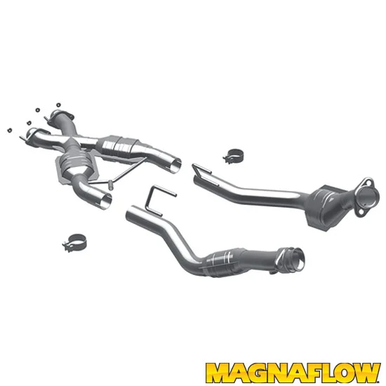

It's $499 at Summit, I'm sure the picture is simply the old one there, and they would be sending the redesigned version.
